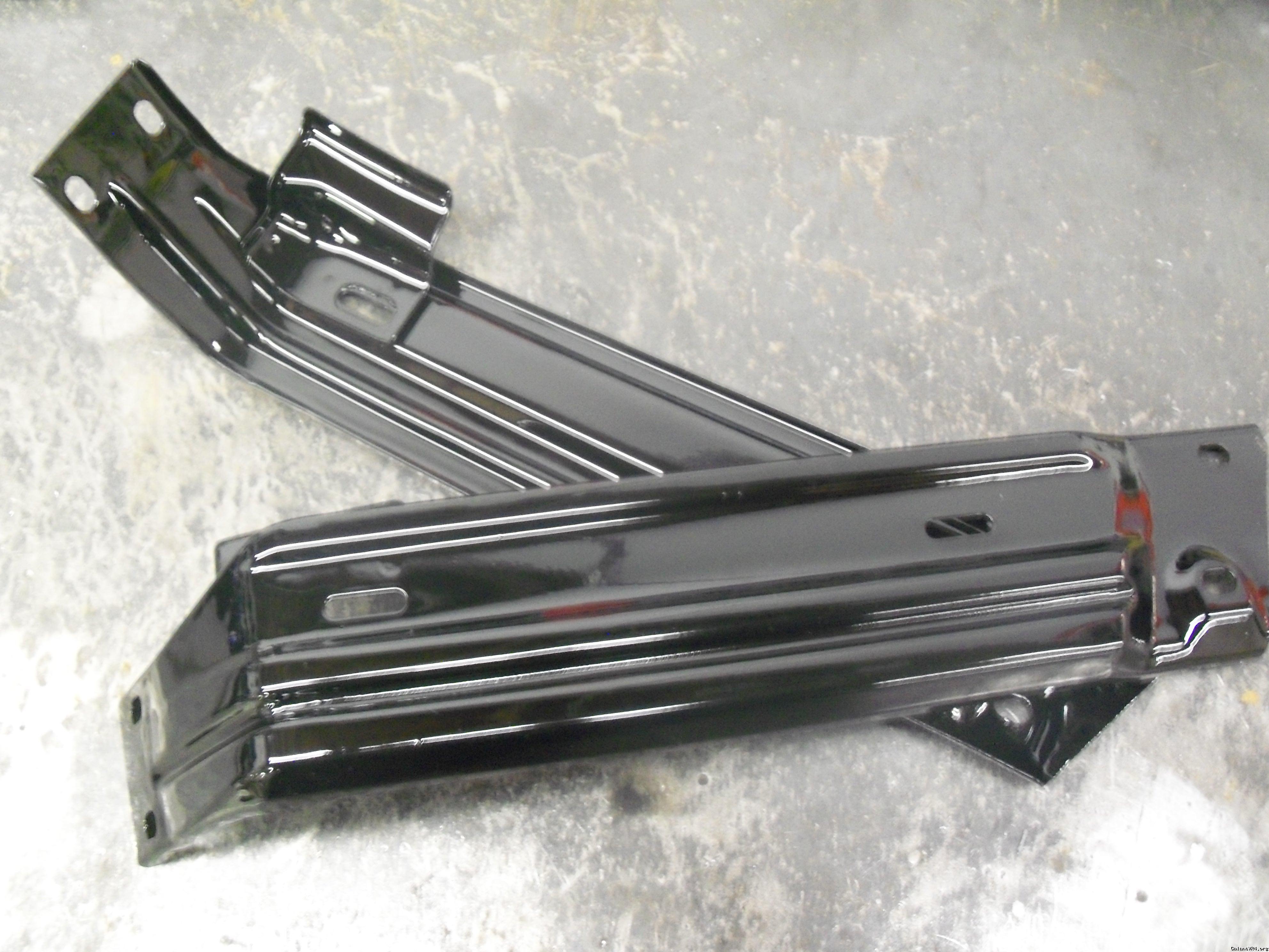

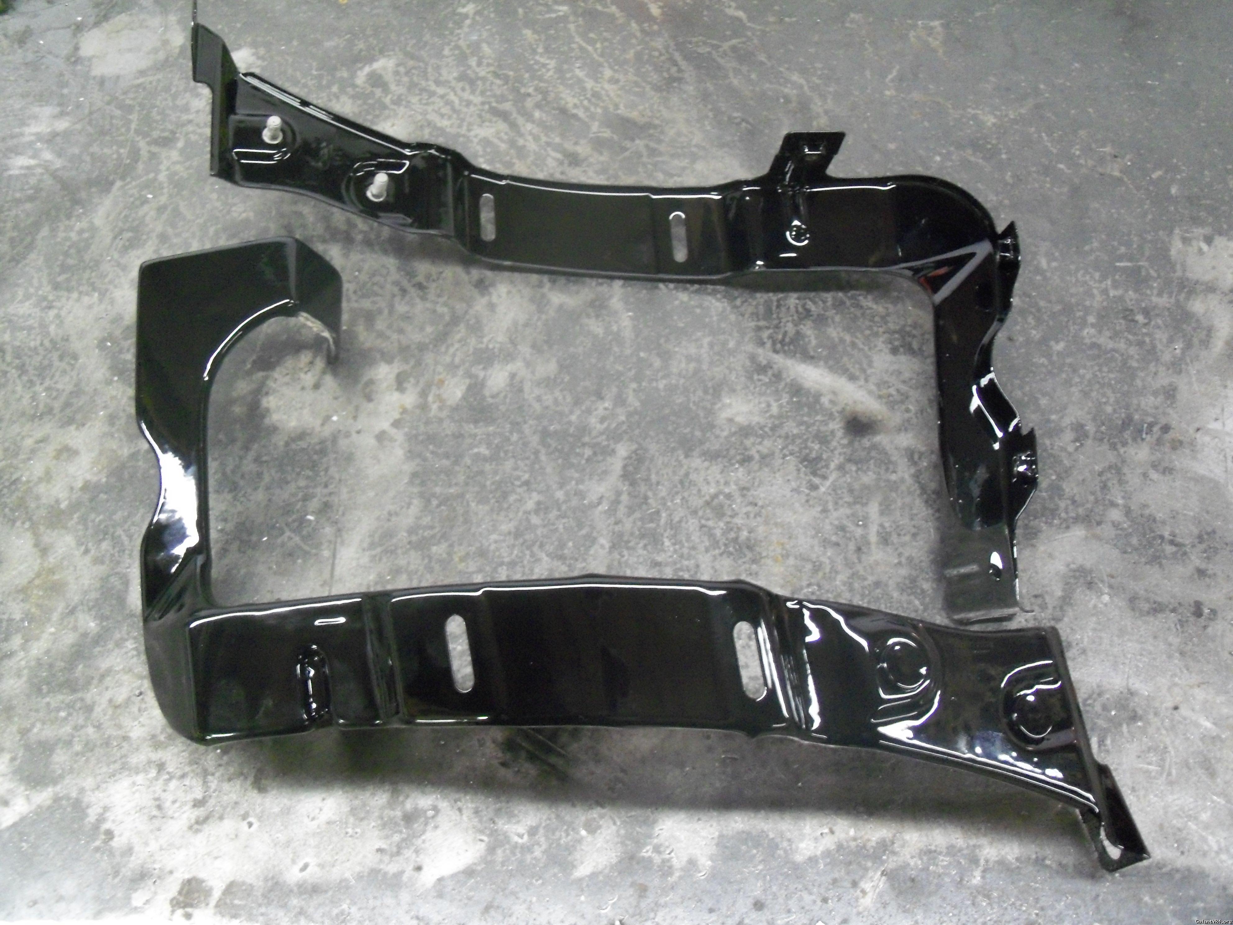

The brewery is still open! Good stuff to I might add. There is also one in New Glarus. Got the front bumper cover off tonight. I will be powder coating the mounting brackets tomorow...oh wait I guess today. /ubbthreads/images/graemlins/tongue.gif I need some sleep.

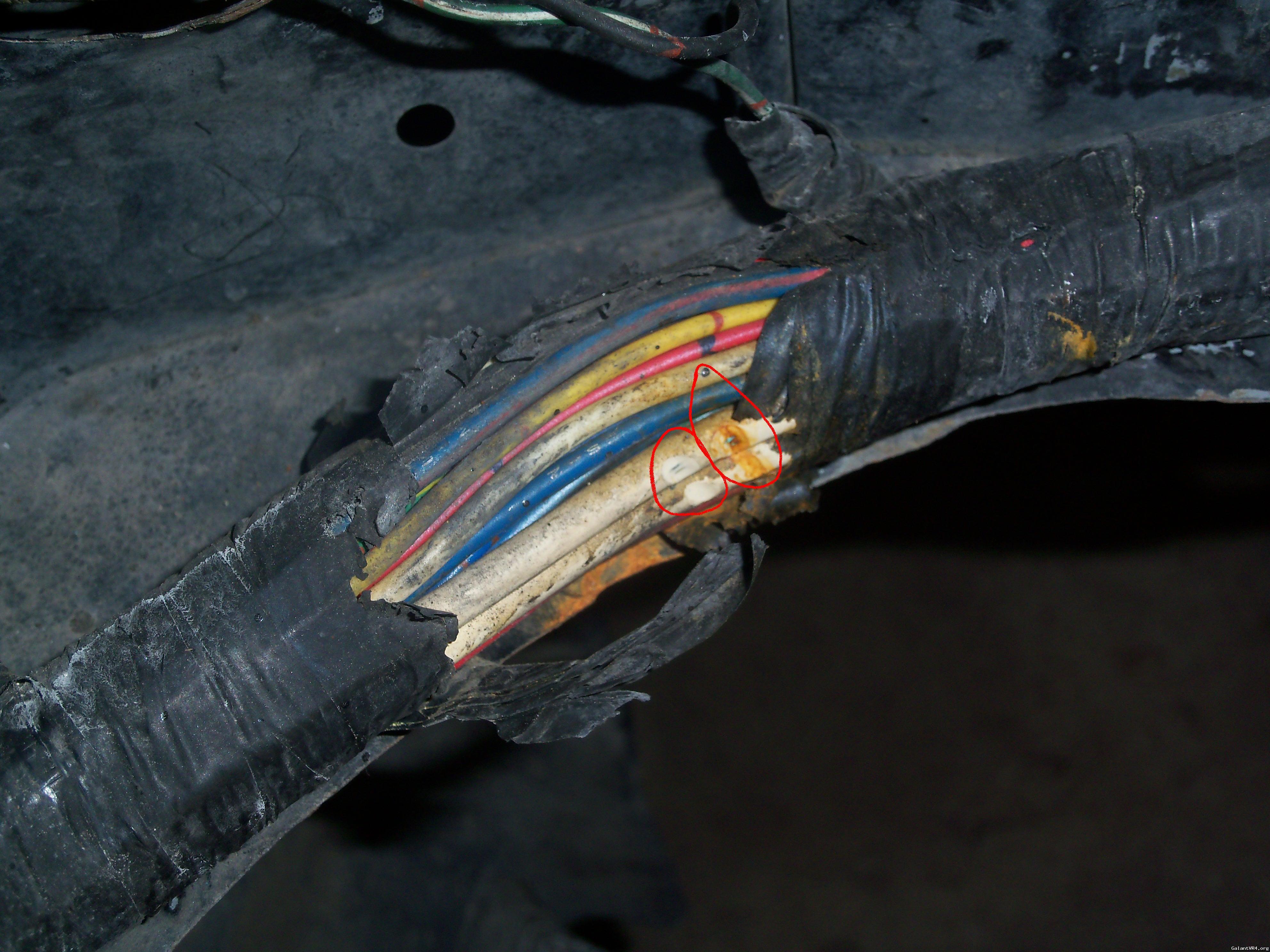

I got my brackets powder coated. I'll be posting pics after work hopefully. I also figured out last night how close I was to almost having to do a lot of work splicing a wiring harness back together. The intake filter was rubbing on the harness and was almost through to two wires. I'll post a pic of that as well.

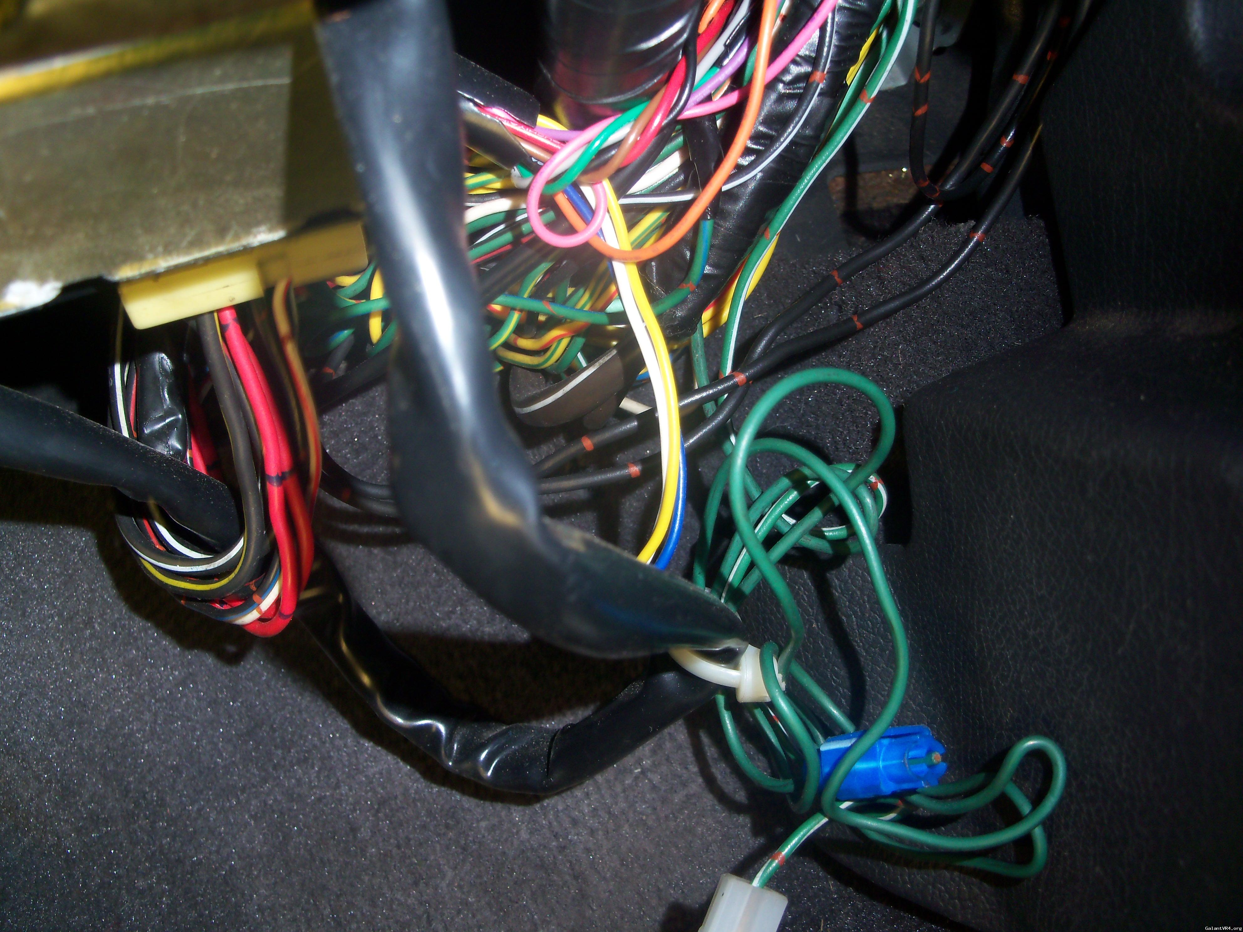

I found out I have a pretty big mess of potential wiring issues. Since I have some time over the next couple months I will be beginning my complete wire tuck. I will post pics as soon as I get a chance.
Where is the wiring issues? Can you take pics? I don't recall seeing anything.
I'll take some when I get home. It's nothing bad on your part. It just isn't up to par with me. I'm very picky about how things are done. I also think I already found the reason the battery wouldn't hold a charge. Nothing to big to fix.
Potential Wiring Issue
Another rats nest.

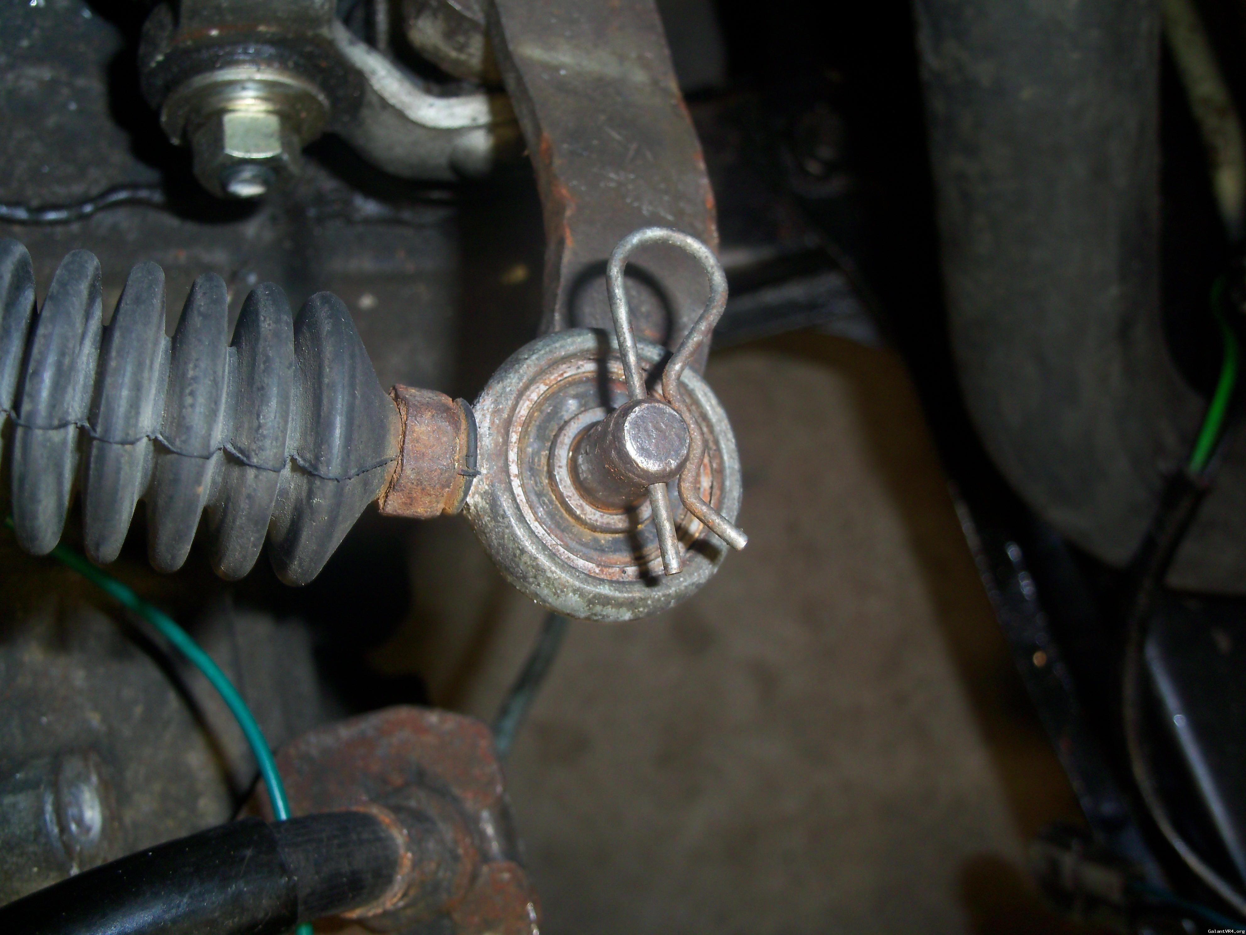

Don't want to hurt your feelings, but these are a no-no. Possible cause of syncro failure. Without proper bushings the cables are allowed to move excessively up and down on the shaft. /ubbthreads/images/graemlins/banghead.gif I will have my bushings in by next week.
