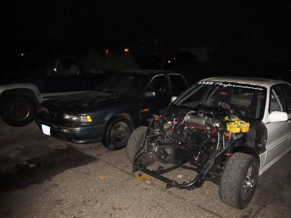

This is my new green 91 Galant VR4 I picked up last week to get up and running as my new daily. It needs a turbo and the wiring fixed. Along with a hand full of other odds and ends. Tonight I fixed up the engine bay harness that was shortened by someone and when I did get the car home it would not start or run, but now it starts.

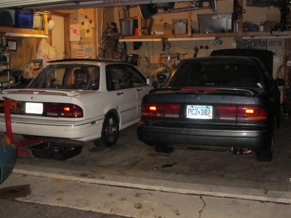

Its the green on the other side of the race car.
Its kind of weird to see them next to each other.

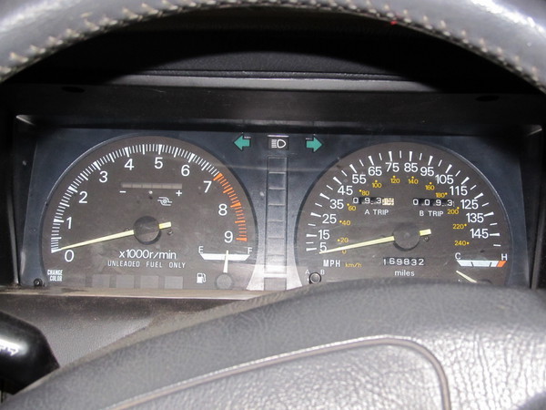

Stock, not much to see here
I looked in the car today and found the factory limited edition key chain.

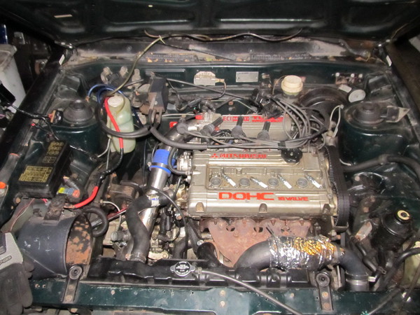

Some body messed with the engine bay harness a little to much.
They were doing it wrong.
I have a Eprom ECU I will use to tune the car. I am going to put the china evo 3 16g on the car and getting it driving around, then I will put some work into swapping on the mutt level 1 I put on the moon taxi, back in the day, and supporting mods to make a fun daily.
It also has the cyclone dual runner manifold on it now, I will do some thinking on if I can make it work like it should, that would help power under the curve a lot, something the moon taxi has none of, could be fun.
It also has a 4 bolt rear end and a 5 lug swap and a small FMIC with some OK piping. We will see how this comes together in the next week or so.
