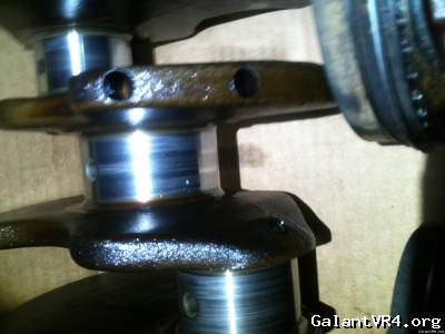

well...i finally got my 4g out and tore apart and its a good thing i went this route instead of just the bsek ...the oil pump gears cover and pump houising are toast from the bs bearing falling out. unfortunately it took the main/rod bearing and crank with it...ill post some pics later..so now im looking at pretty much a rebuild...good news is she doesnt need any machine work just some cleaning and a bunch of new parts hahaha....does anyone sell a new crank that isnt 900 dollars? anyone have a cheap used one?

make sure to take those rods in to make sure that the crank side isn't out of round. with everything chewed up like that, even if it wasn't making any clanking, they could have gotten knocked around a bit.

I've been reading alot on cut and polished 4g63 cranks and it is really back and forth... Some people turn em with no probs and others say no way.. Has anyone had experience with a turned crank? This motor won't see big hp numbers and I would like to run it but not if its a ticking time bomb...
