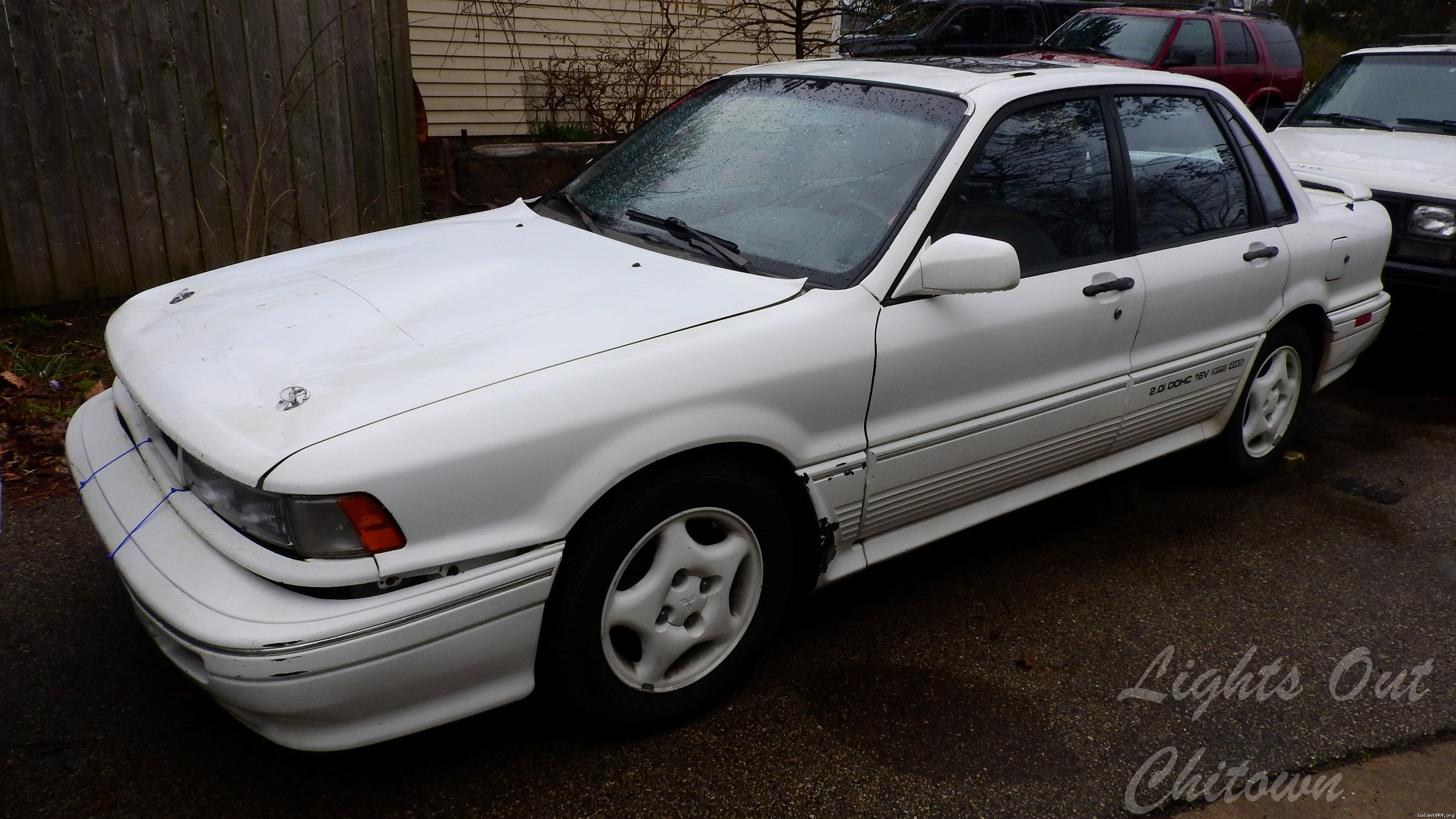

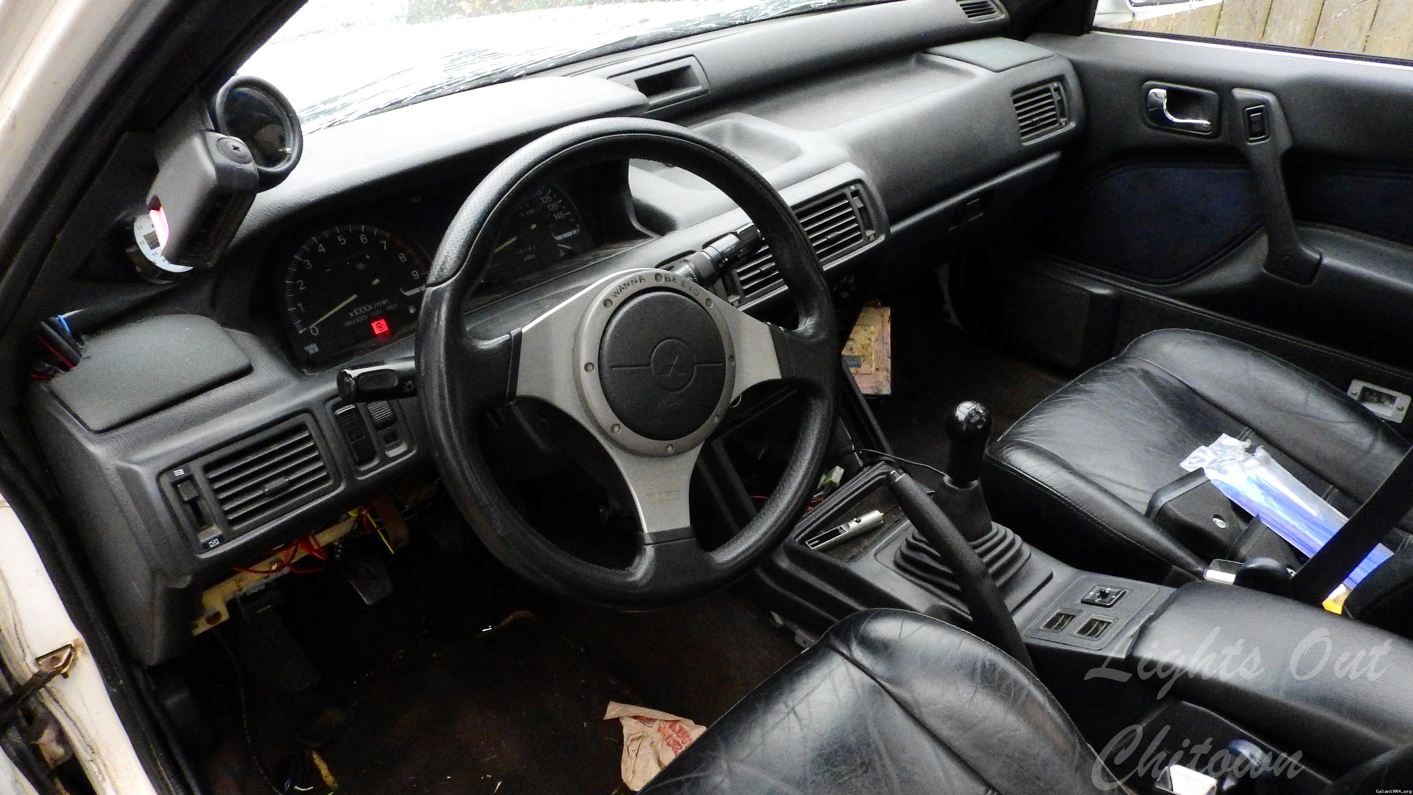

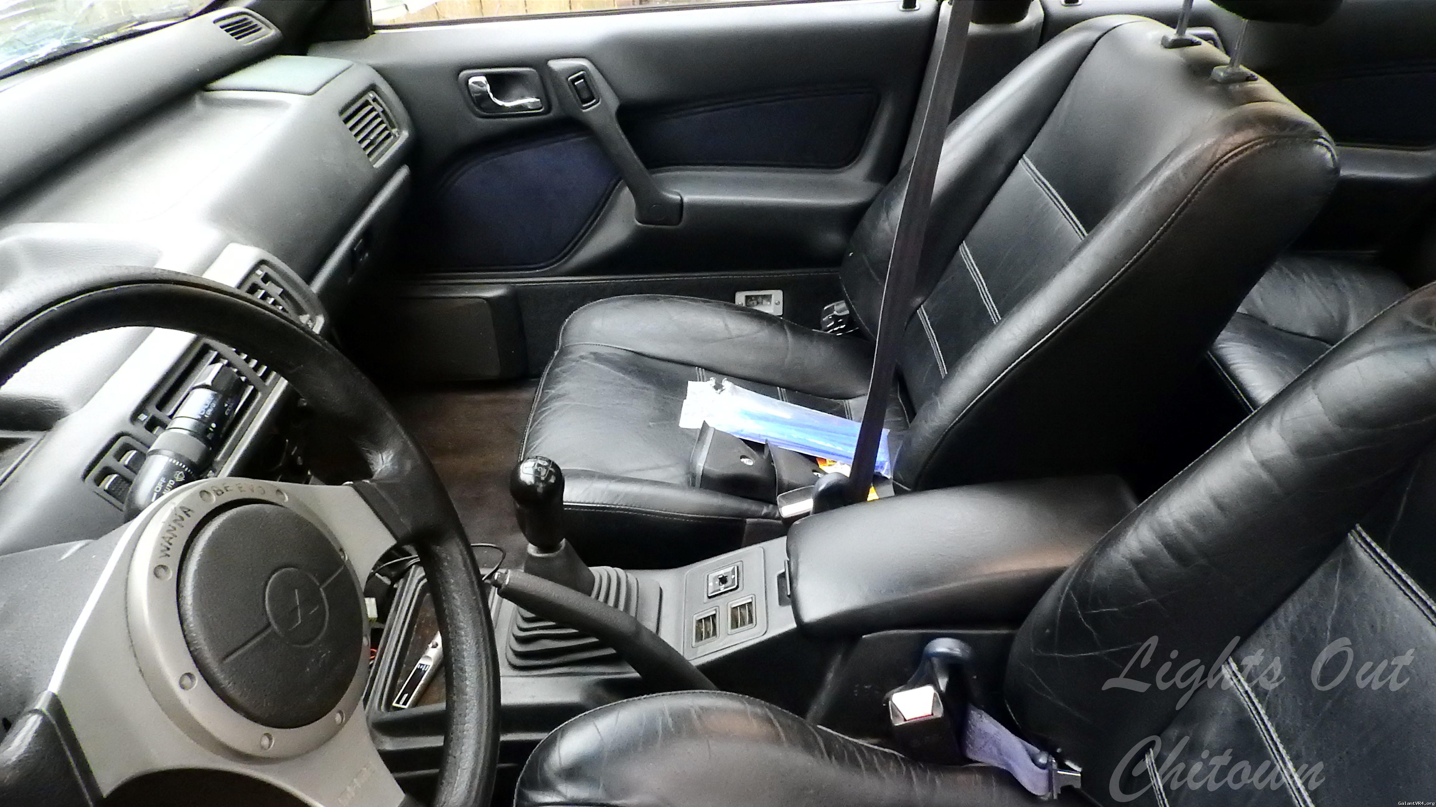

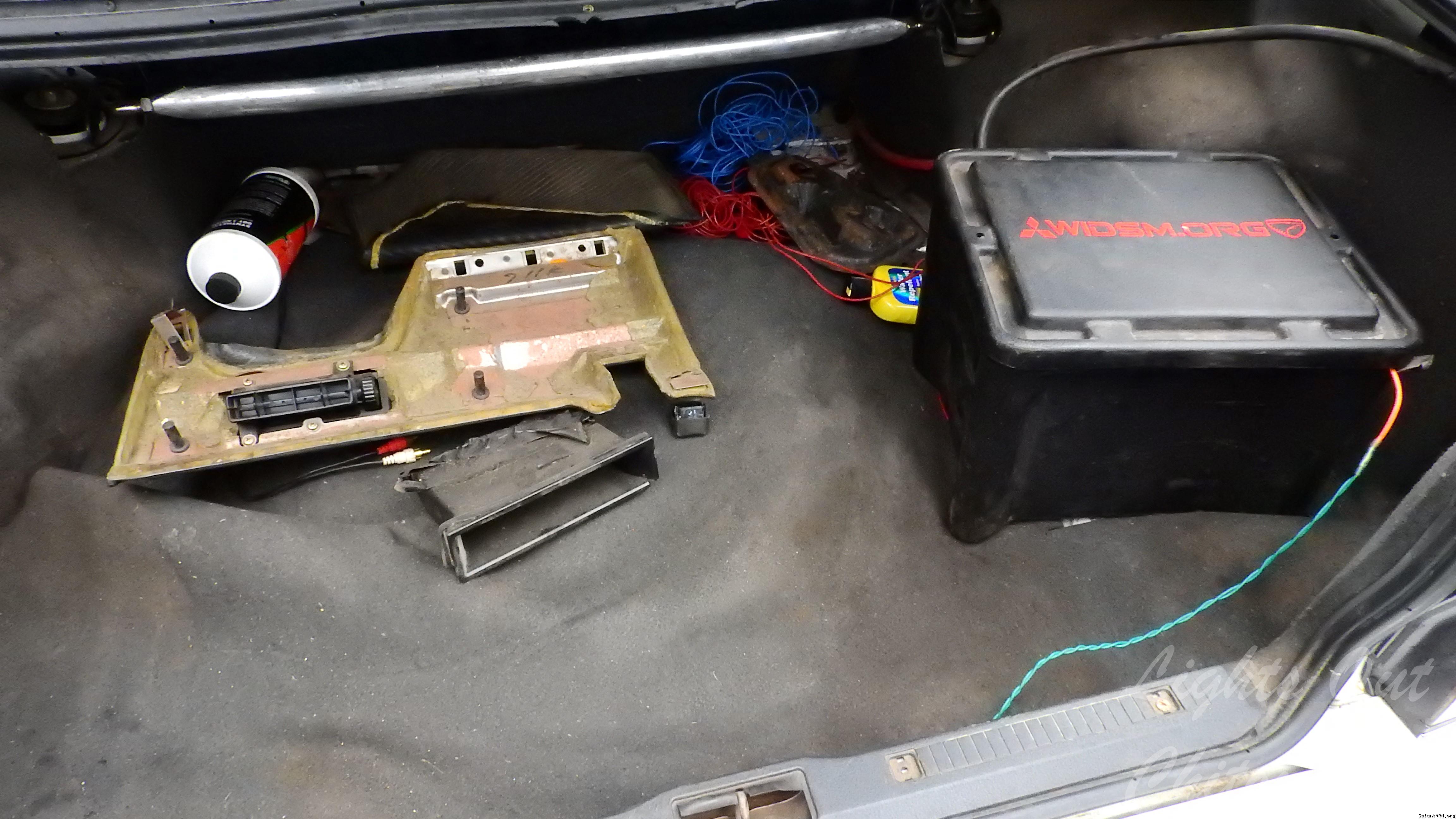

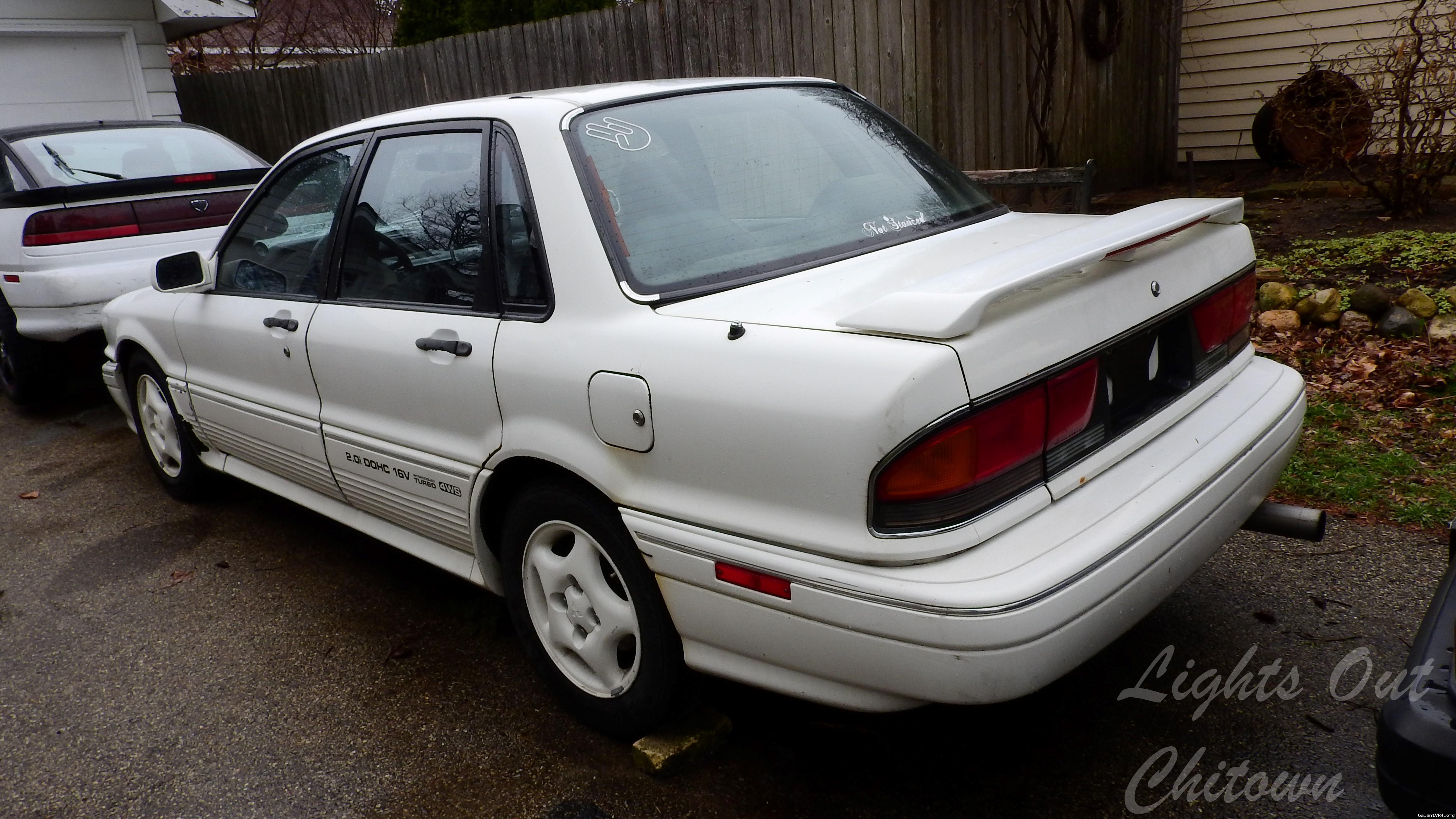

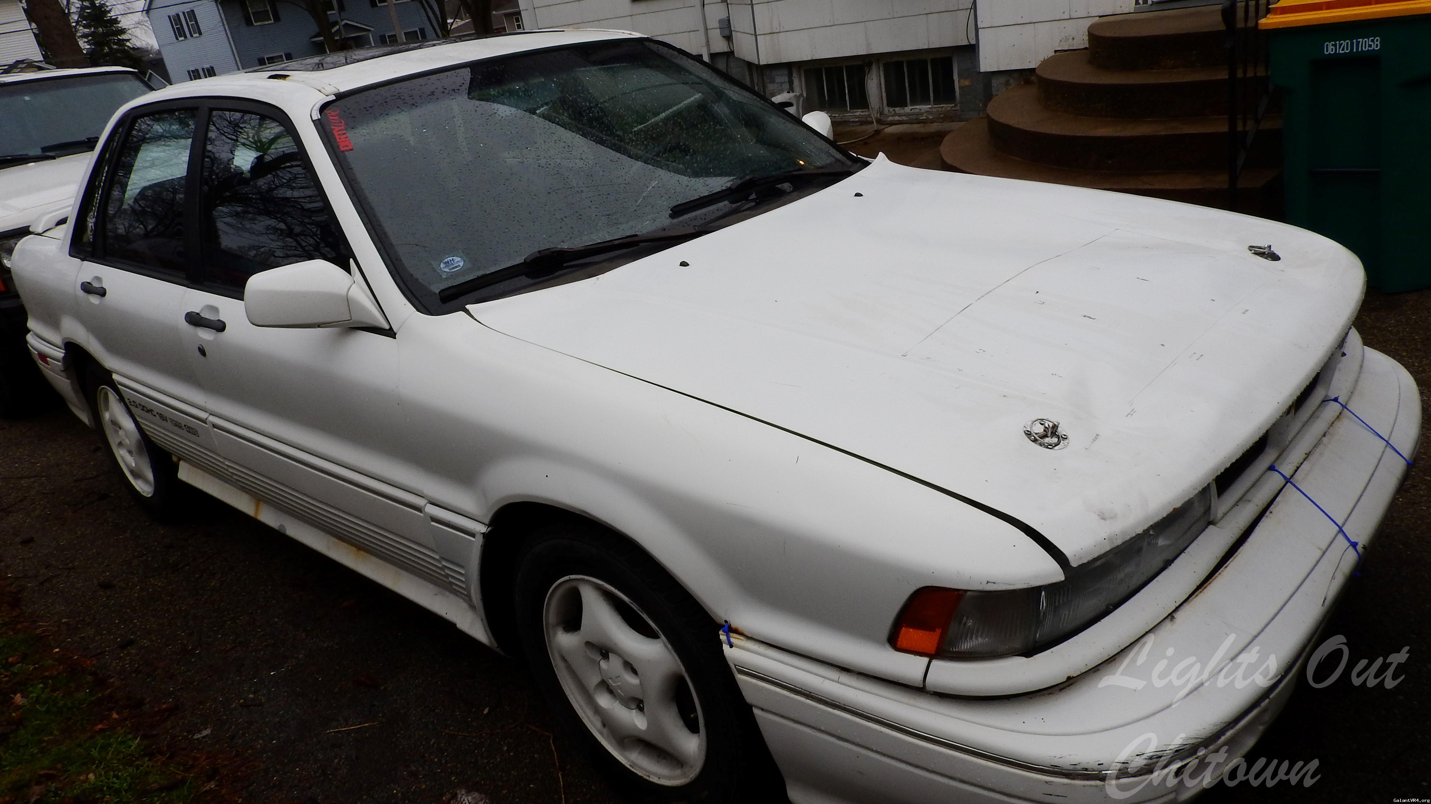

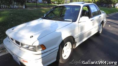

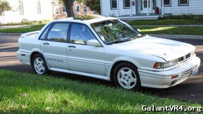

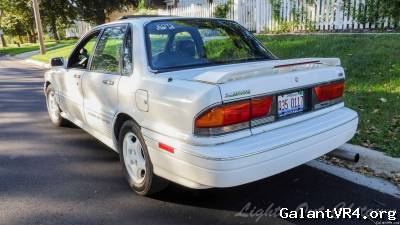

Well been on the forum for awhile but never introduced myself or my vr4. I picked up #313/1000 back in spring and after dealing with title issues finally got it all in my name in late May. Slowly have been fixing the various issues it had when I first bought the car; Fixed the windshield, fuel pump wiring from hell, battery relocation to match the quality of the fuel pump, fan wiring as well... The paint looked very poor but after many hours of rubbing compound, polishing, and carnuba waxing it started to look less neglected. The car had previously hit a deer so the windshield was cracked, the hood is dented, and it appears that the bumper support was removed after, so currently it is held by zip ties(despite my many attempts to locate a bumper support).

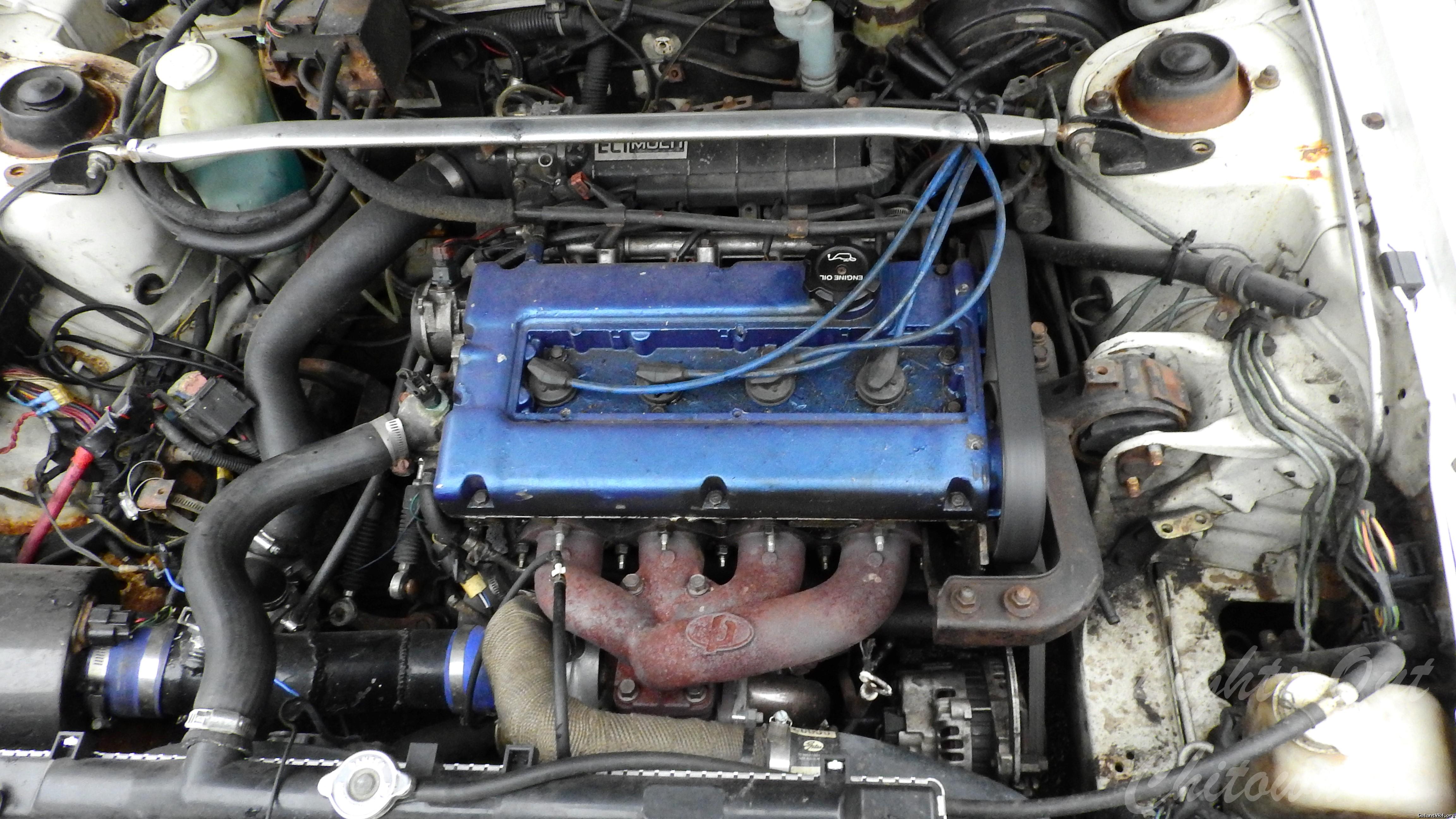

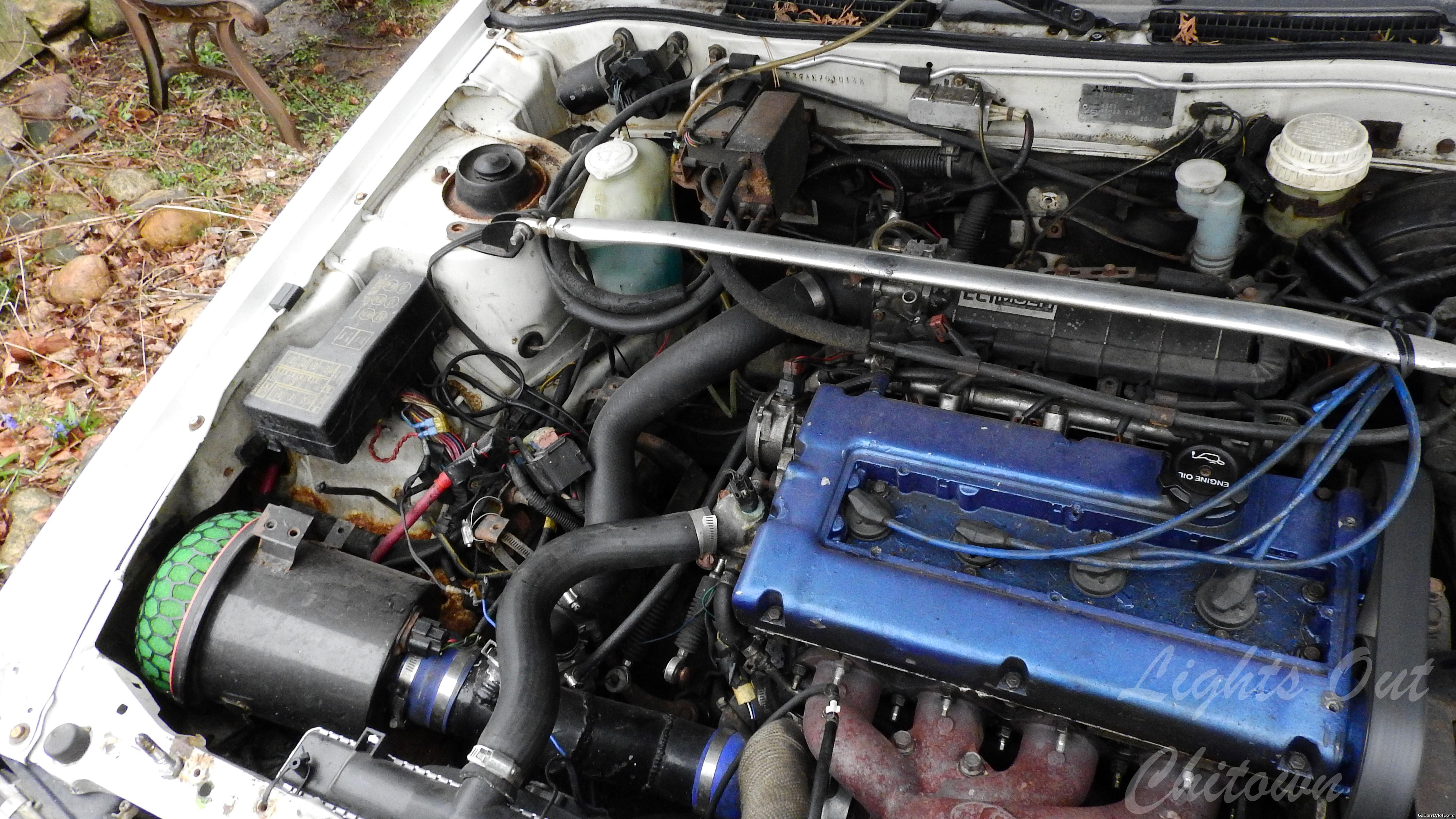

Now to the better side of how I bought it, the car has a .020" wiseco pistons(8.3:1), (supposedly eagle rods however I believe they are stock rods), arp hardware, balance shafts deleted, 20g Godspeed turbo, evo 8 injectors, aem uego, aluminum radiator, lightly ported head, chip tune.
Photos of when purchased...

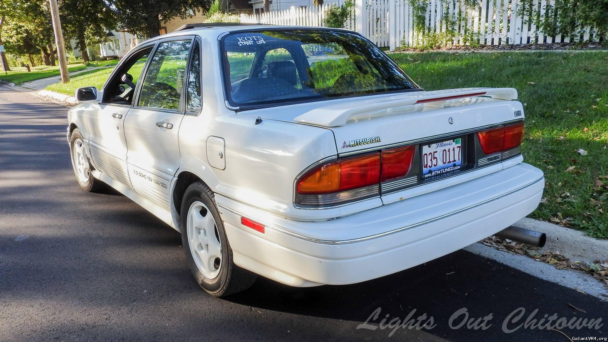

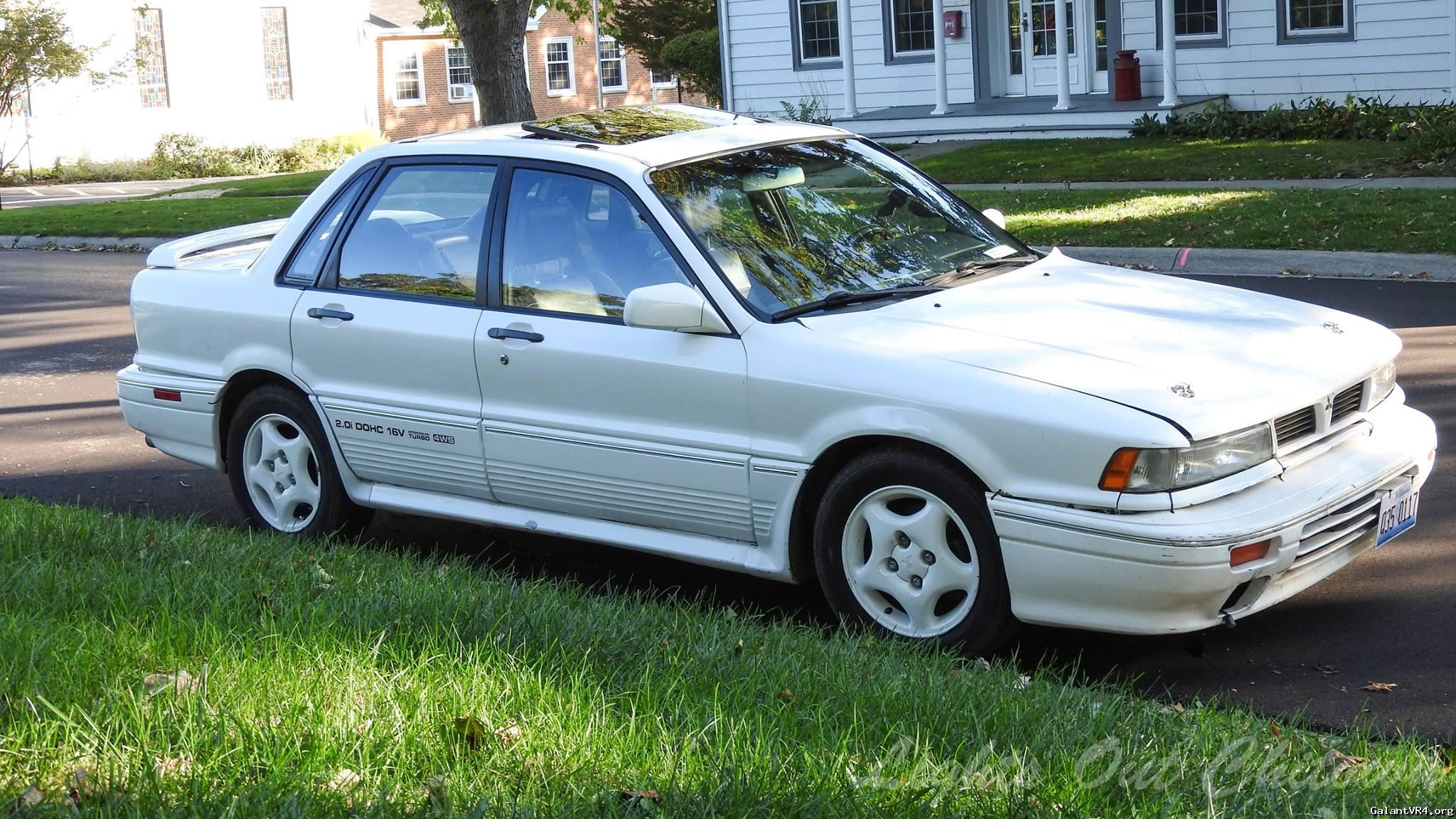

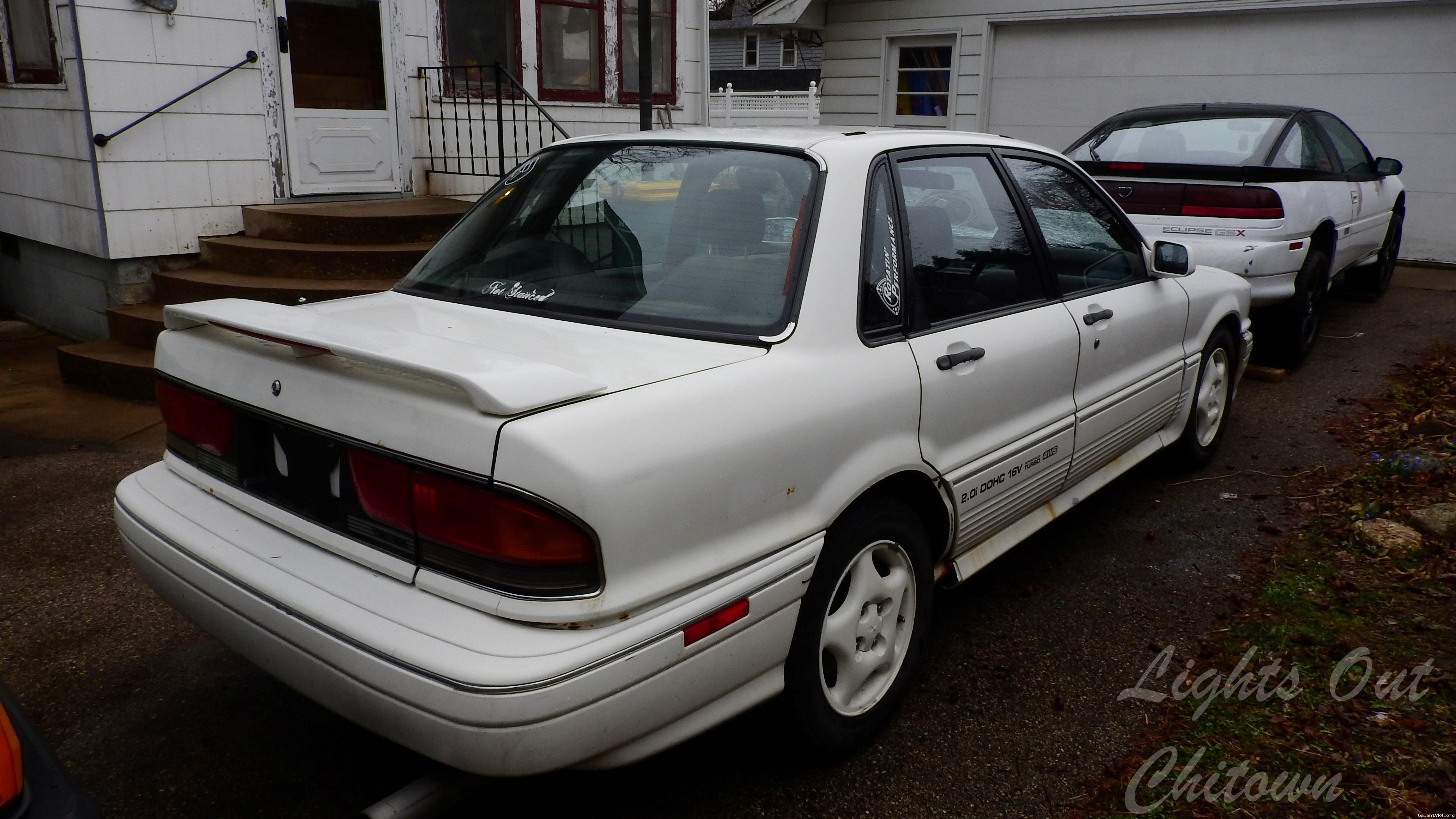

Recently picked up DSMlink v3 and have begun tuning but sadly I am 6hrs away from my car for the next few weeks, so I will not be able to finish for awhile... I also picked up SD and will be switching over to that soon. I will be picking up an electronic boost controller and will likely run around 22psi, my goal is to eventually get the car to be a 400awhp daily, however I will need a change of injectors, turbo, and a few other things before I can work towards this.
Here are some more recent photos since I worked on detailing the car and fixing some issues such as windshield, missing badges, and dogleg...

Well engine bay still makes me cringe from all the wire that the previous owner mangled, but at least the center of attention won't be a peeling blue valve cover, think the wrinkle black w/polished letters turned out pretty nice!!
Also in other news, the 1450cc Injectors have been installed, still need to pick up some fittings for the aeromotive a1000 fpr, mounted the map sensor but need to route a boost/vac reference, looked into finding my fuel leak issues(still working on that)...
