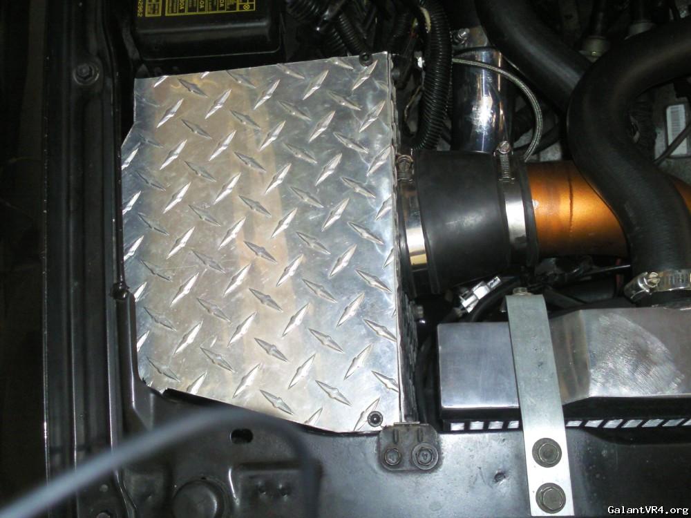

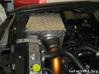

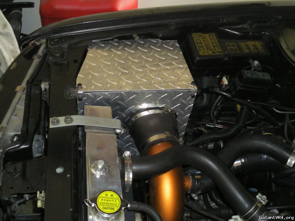

Its really early in the morning, so its kinda hard to understand the meaning of your last statement... But It crossed my mind because the last log i made with V3, my ait temp was between 130-160. Although it was idleing for 20 or so minutes in 80degree weather...but even so, i drove it around for 10 minutes and the temp was hovering around the same numbers. Here are my options that i came up with...
1. Header wrap-$50
2. Air filter box(which i just did)-free
3. Ram air/relocate my filter in the wheel well-$50 to $80
4. Unplug the wires for the ait temp in the mas and run a sensor near the throttle body. -$20-$30?
Although i have'nt made any logs with the filter box...I'm pretty sure, I'm not going to see a huge drop(50-70) like the temps I've seen in the Ecmlink forums. And even if i did...the temp would not be the same when it passes through the intercooler.
