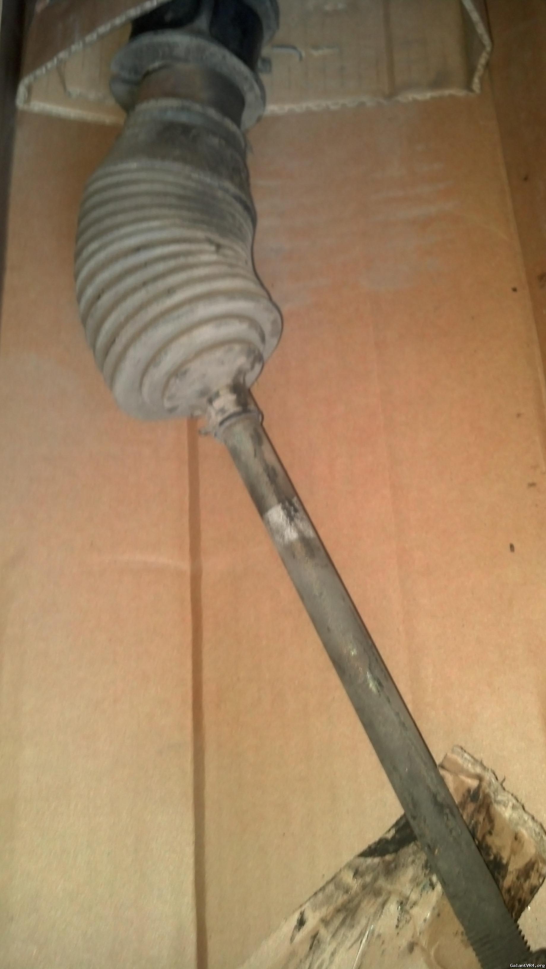

Partial of the manual steering rack. Ewww, needs a rebuild and cleaning

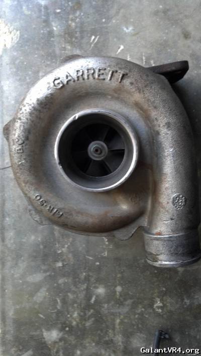

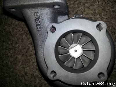

The HKS turbo. Soon to be shipped out rebuilt and upgraded /ubbthreads/images/graemlins/devil.gif

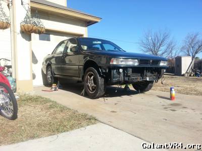

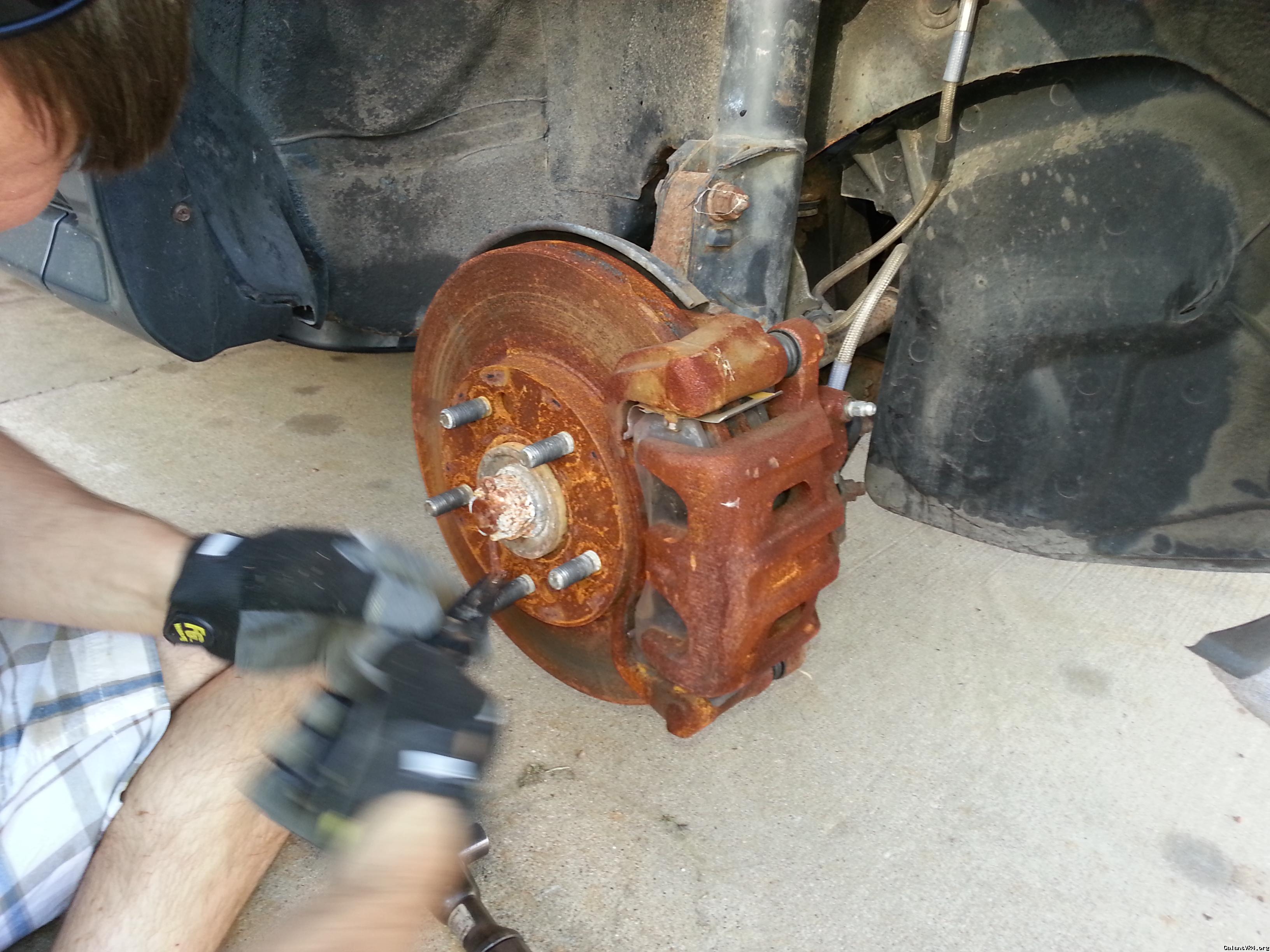

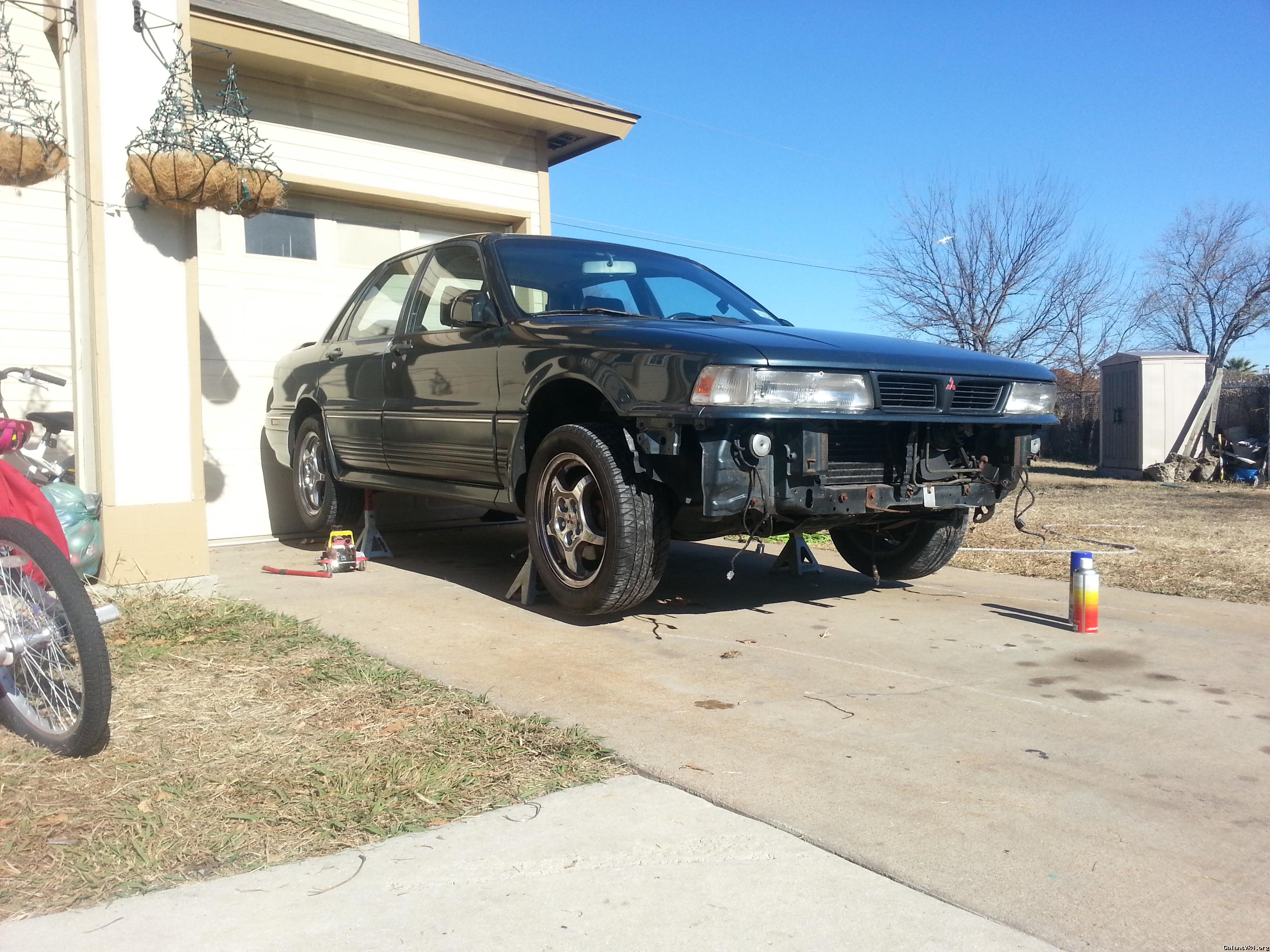

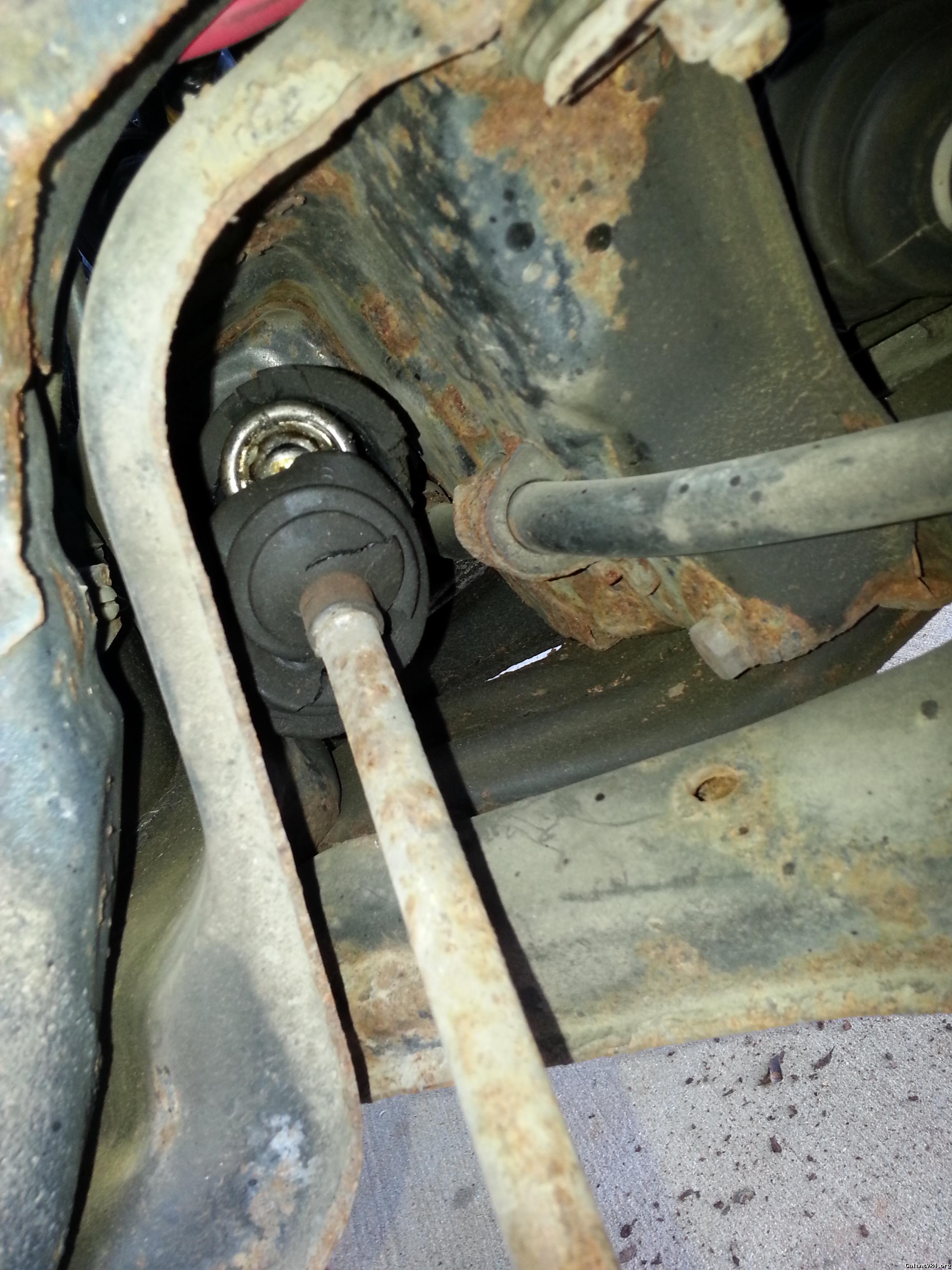

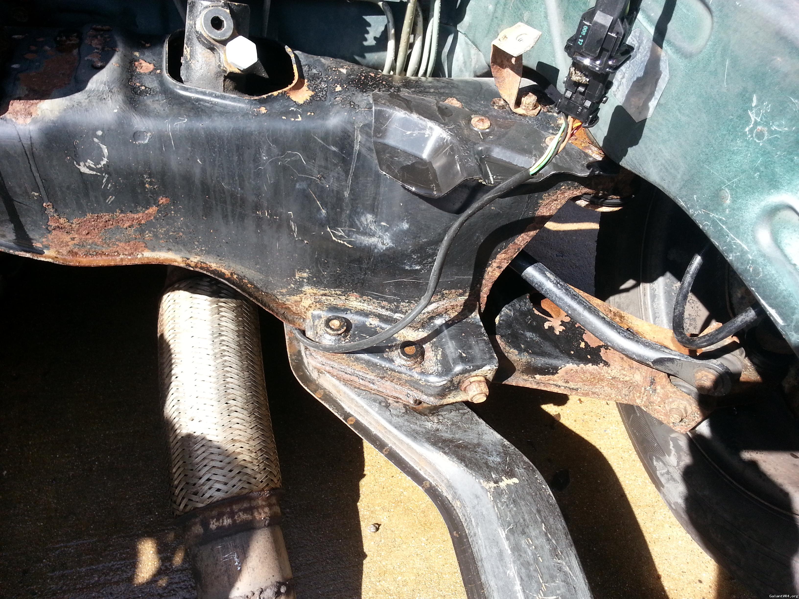

282/1000 is now in my friends driveway so its a lot closer and easier to work on. I have been collecting parts and doing a little bit of work lately. Today I tried to pull the motor but ran out of light/patience. Tearing everything down has been kinda depressing. I have found a lot more rust than I remember and its just taking so damn long. I miss driving my Galant. The CR-V just doesnt do a damn thing for me emotionally. lol
Anyway, Here are a few pics. If there is anyone in the area that likes free beer and food in exchange for wrench time on a GVR4 please let me know. I have a lot of work to do and Im a bit out of my comfort zone doing this much in depth work.

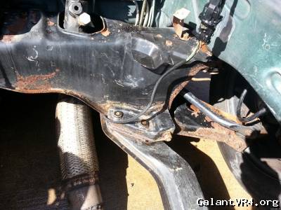

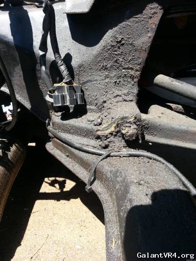

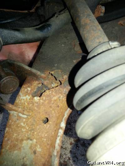

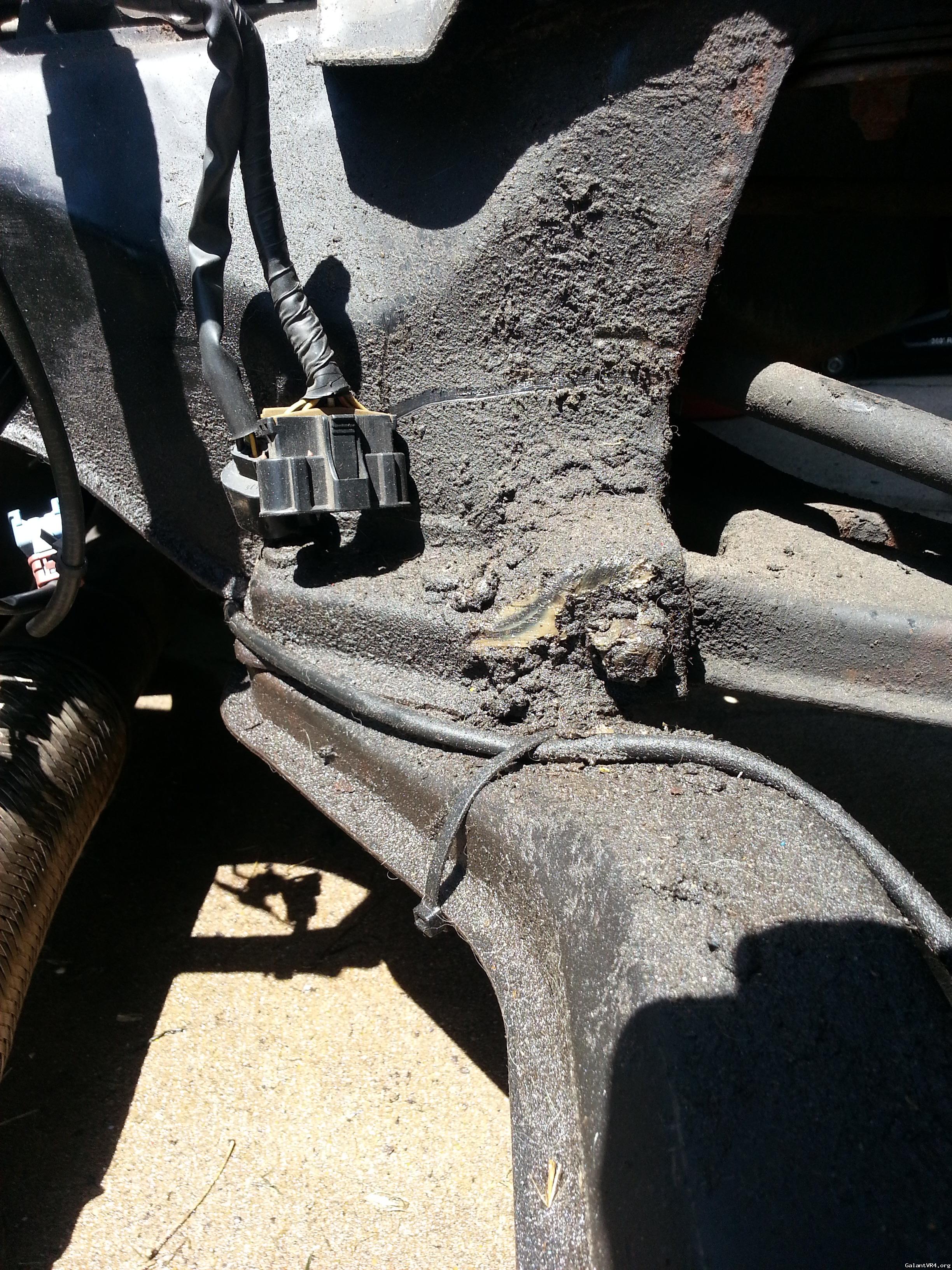

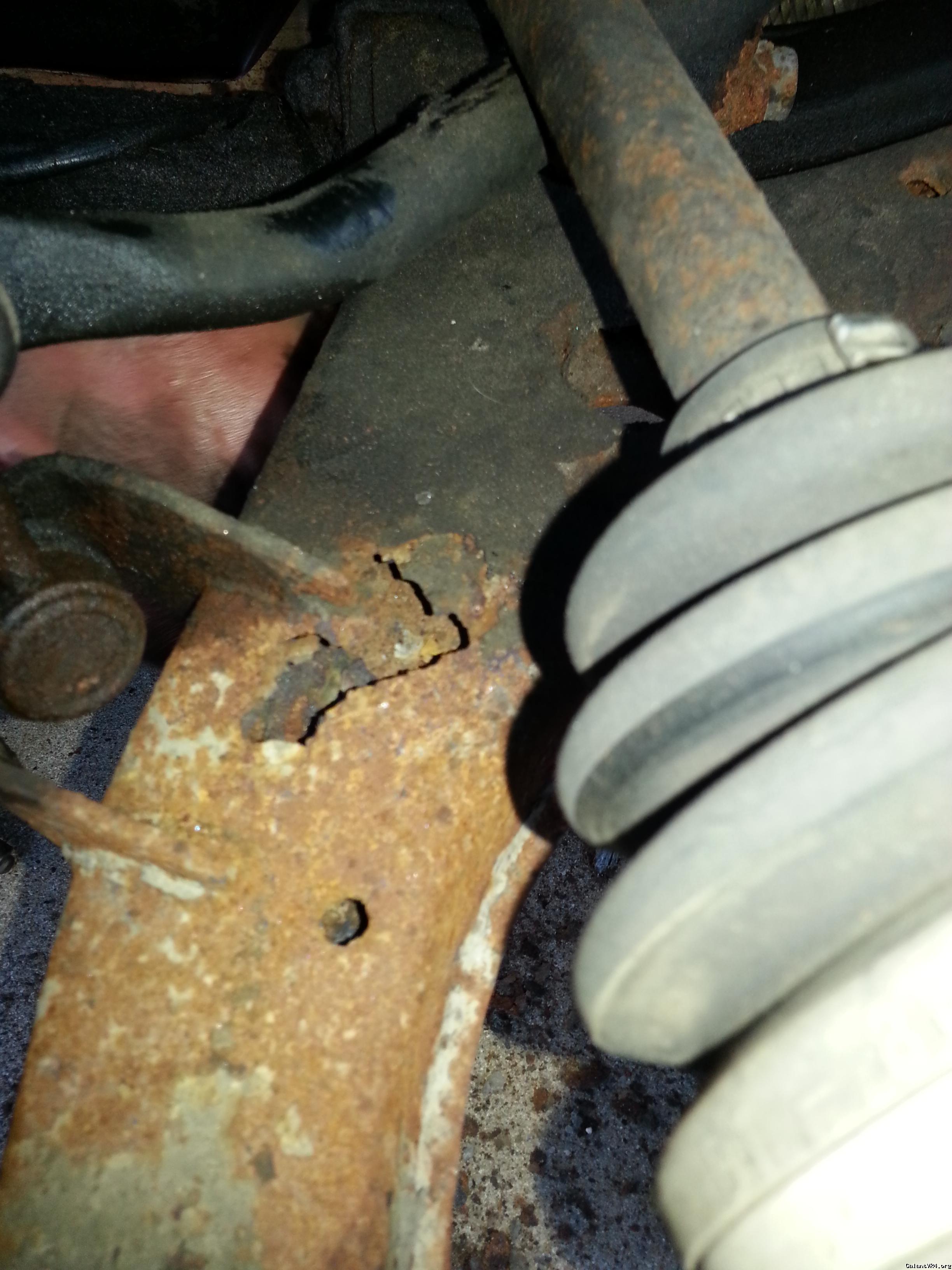

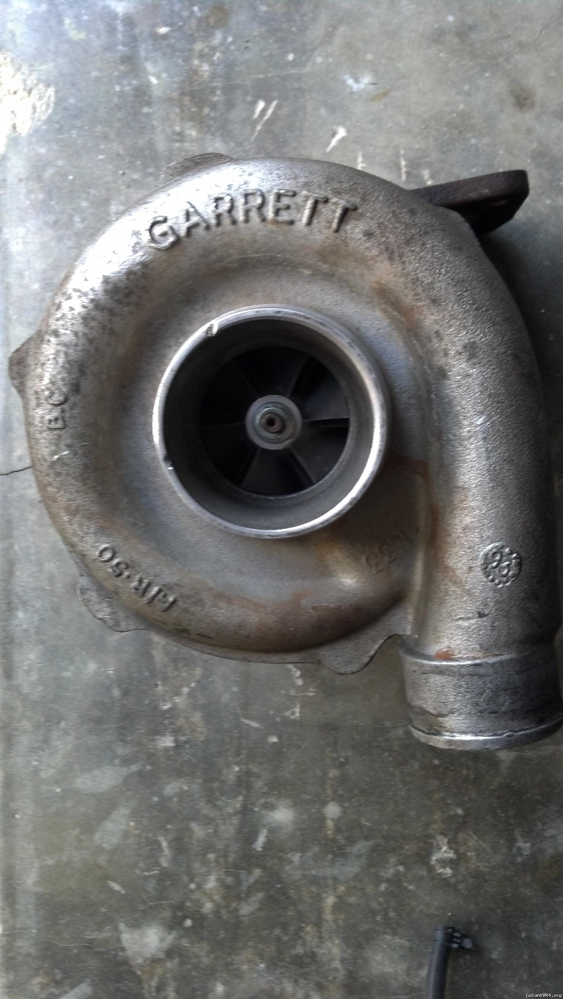

Well thats no good
sonofabitch! I hate rust!!!!!!! /ubbthreads/images/graemlins/mad.gif Are the rock auto arms a good replacement?

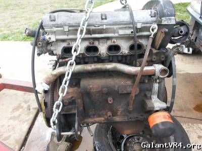

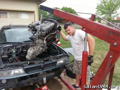

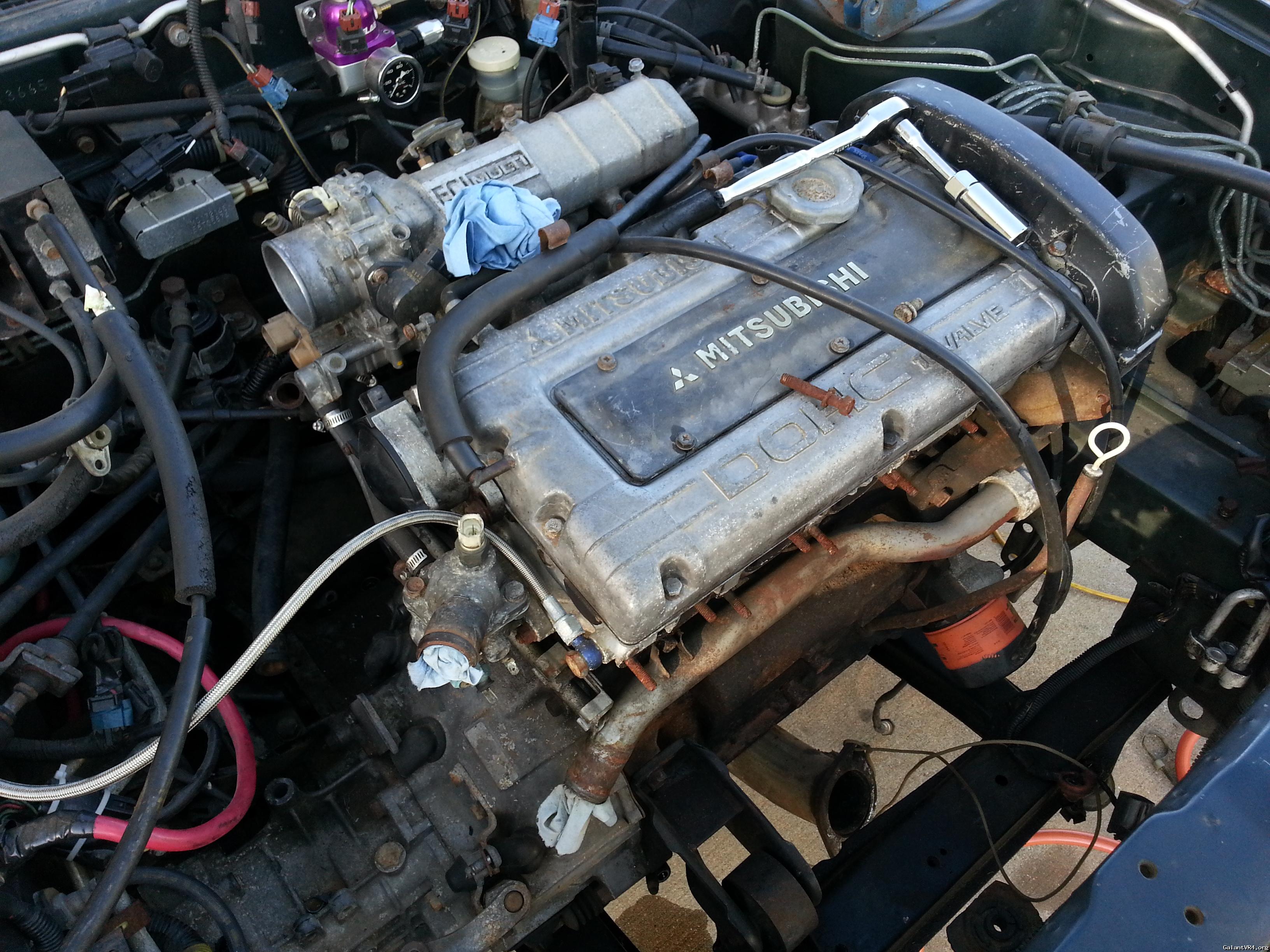

And then we ran into a few snags and couldnt get the motor out before we lost the light.

Keep up the good work! I'm no expert but feel free to txt at any time if you have a question and i'll do my best to answer. Shane and Phil were nice to offer that to me during my build and it helped a ton!
If it's a tight fit, try removing the water pump and crank pulley, that extra "inch" just might be enough. Also I removed the trans mount from the trans when I pulled it that way.

Rockauto doesn't make any parts they just sell them. The cheaper ones are Doorman and are built well but I've had the balljoints go out kind of fast. I sprung the extra $20 for the Reybestos the next time.

The car is in Texas now, where is it from originally to have that much rust? I would invest in a new shell. It will make all the work that much more worth it if the car is clean.

I bought the car in PA and then took it to Fort Drum in upstate NY for about 3 years. They freaking love salt on post. They lay that crap down thick all the time. Most of the rust is on easily replaceable parts. There isnt too much anywhere else and whats there can be taken care of relatively easily(I hope)

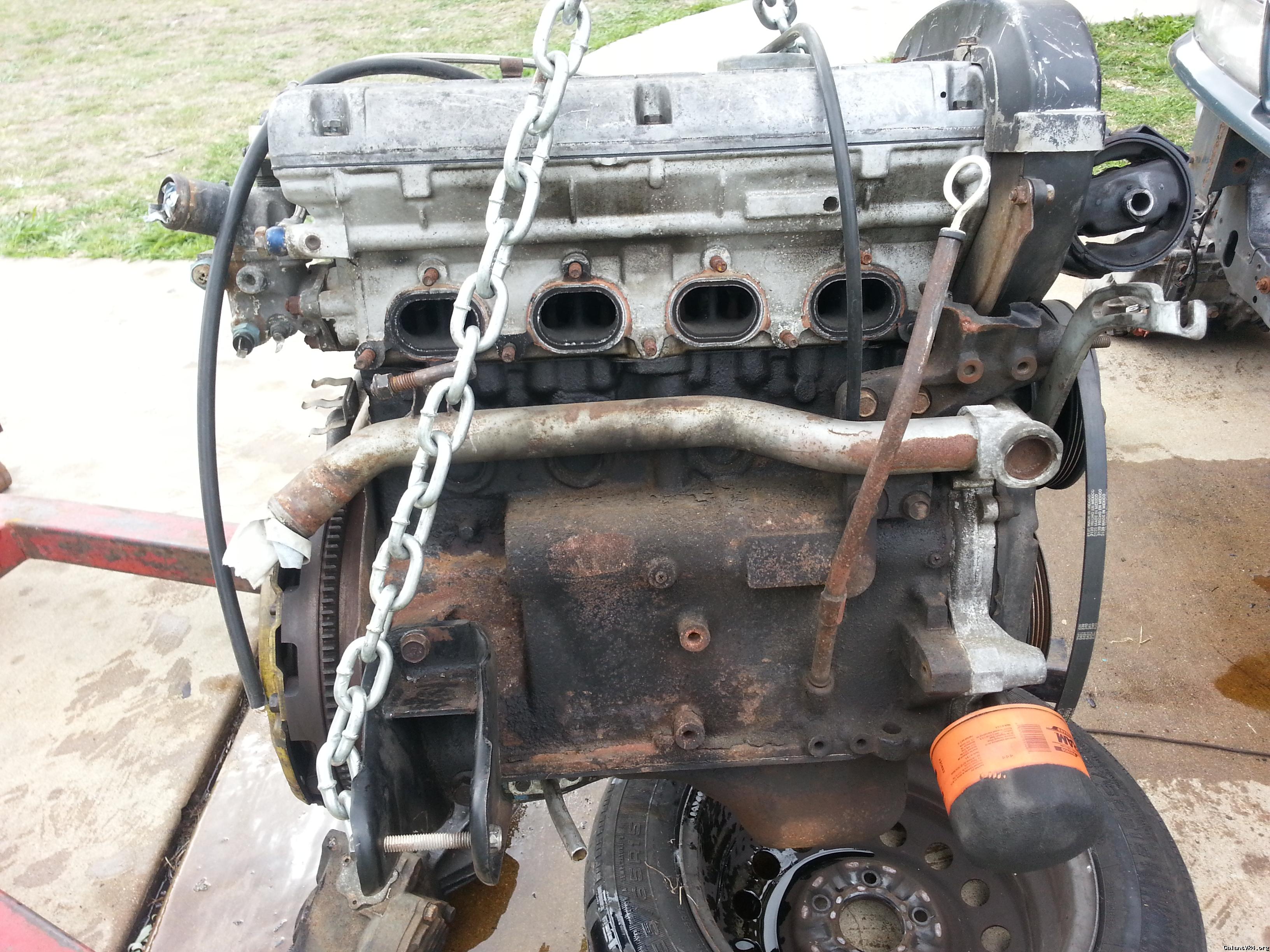

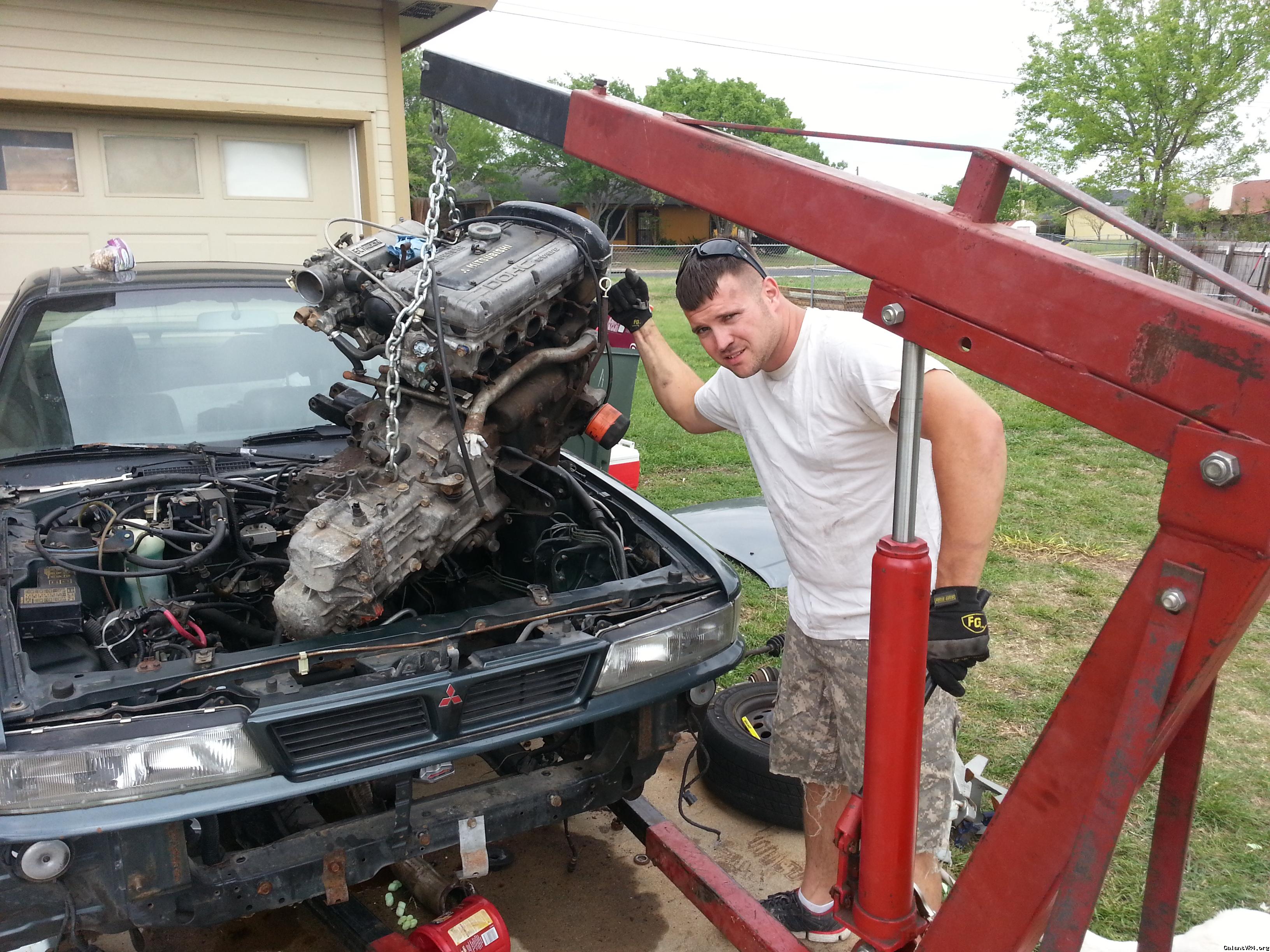

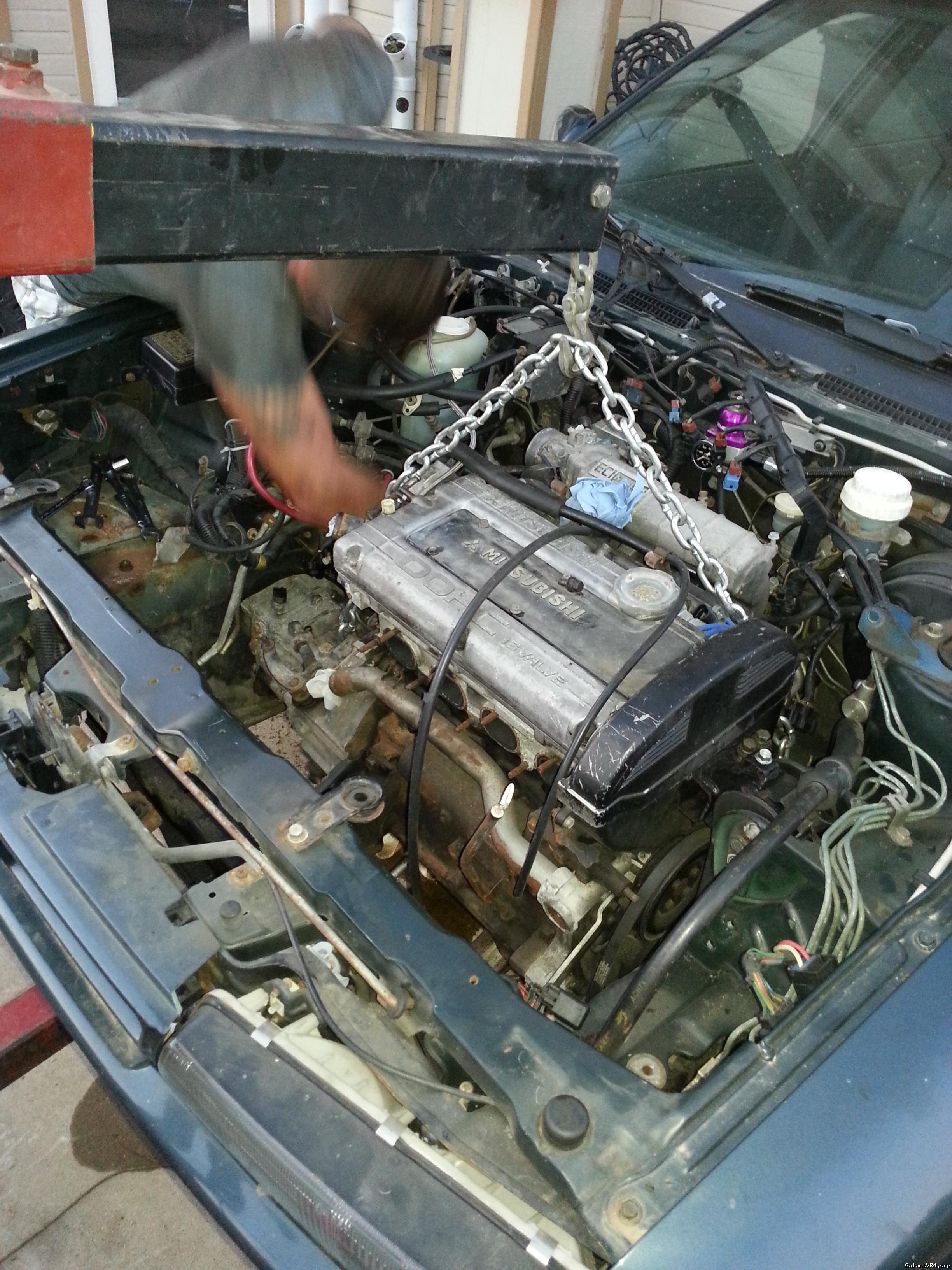

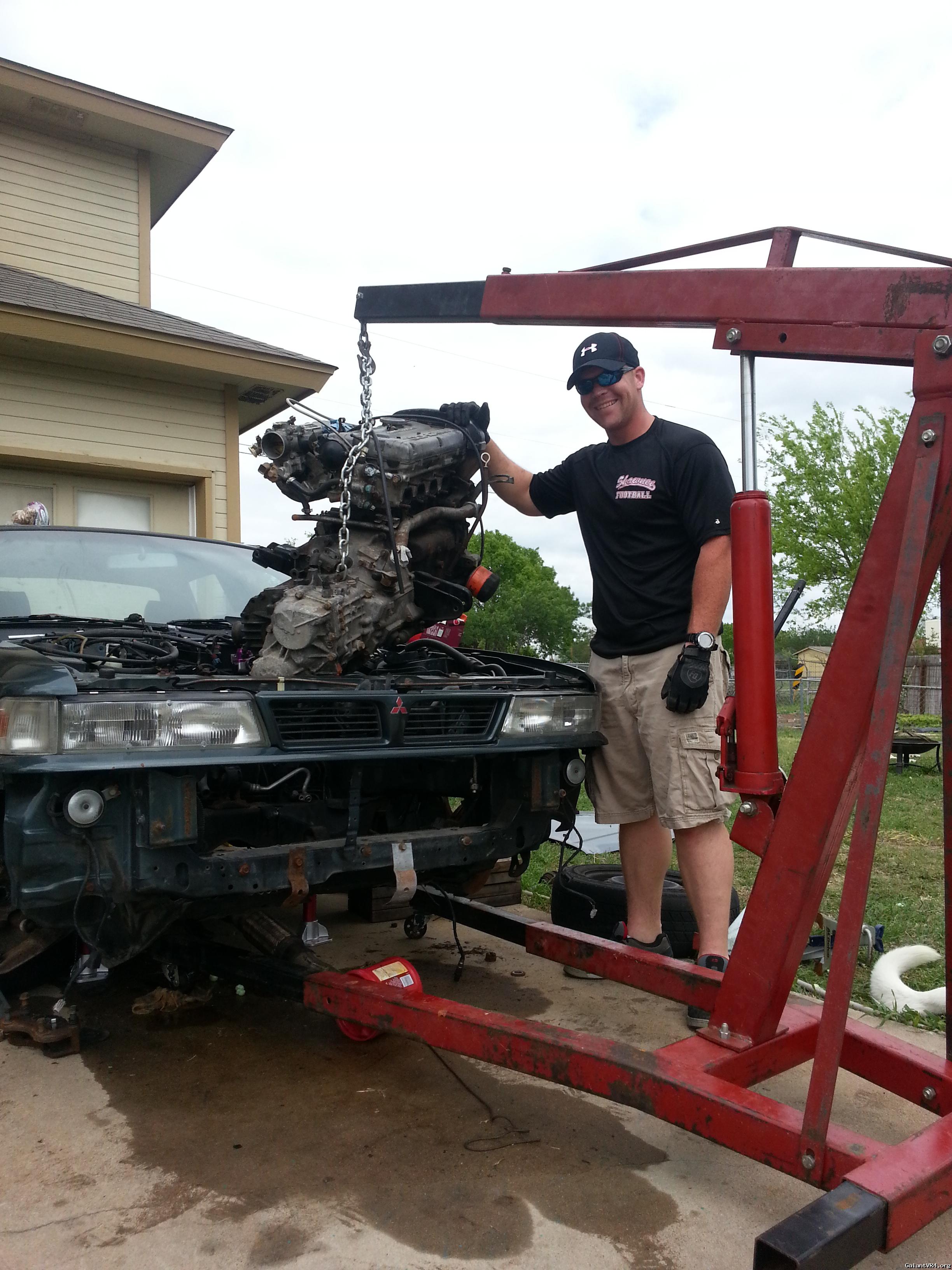

Anyway, update as of April 21, 2013

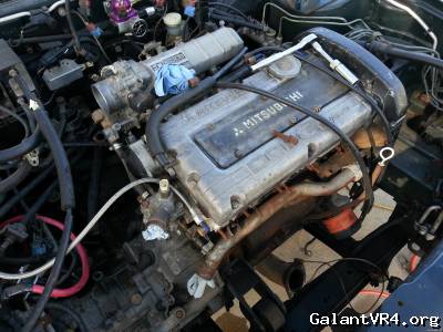

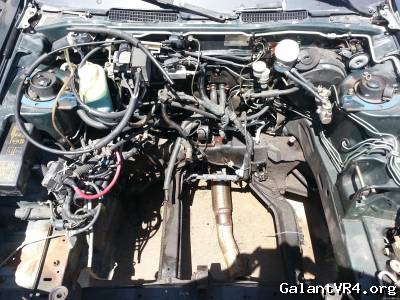

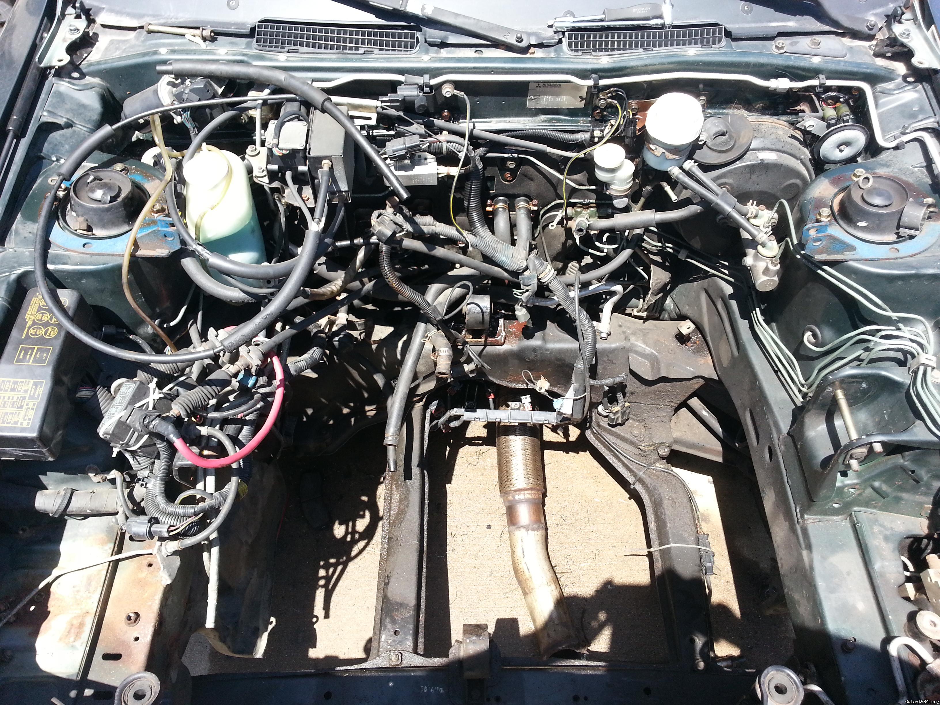

Finally got the motor pulled today. It wasnt all that hard to do once we had some light and got to look around and see where and how it was getting jammed up. We also pulled the trans and t case off the motor.
I have a lot of cleaning to do in the engine bay. I need to get it all torn apart and wire wheel and scrub everything and then repaint and reinstall the stuff Im keeping. Im also going to try to do a bit of a wire tuck to declutter under the hood. After that its get all my pretty new parts in and get my poly bushings installed. Once I get the front sorted out Ill move on to the rear. Pretty much doing the same thing back there. Im gonna pull the subframe, clean and paint it and replace anything that needs replacing. Its gonna be tedious. But for now, pictures
My buddy Brian. I couldnt have done this without his help
Me, feeling victorious
Needs to be cleaned up

Alrighty. I finally had some free time to do some more work on the G today.I decided to start cleaning up the engine bay.
This is what I started out with
Pretty grimey. I used some random extra strength degreaser from the PX and a stiff bristle brush and scrubbed it pretty well. Then I rinsed it off with a hose and repeated the process a couple more times. After that I got a bucket of water and some dish washing soap and scrubbed the areas I could reach with a sponge a couple of times. This is what I ended up with
Dont worry about the rusty control arms. Those are being replaced with new ones in the next couple of weeks. My biggest concerns right now are taking care of the rust in the engine bay and getting rid of unnecessary crap under the hood. I hate how it just looks like a clusterfuck in there. I have no idea how to go about doing a partial wire tuck and Im still undecided as to wether or not to keep AC and if I want to deal with trying to make my 5 lug swap able to have ABS or if Im just gonna delete it. If I delete it then I will need to source all the parts to make it a non hacked non ABS car. I also need to get rid of all the power steering lines since Im going to a manual rack.
After all that is taken care of then its just a matter of shipping Phil all my motor parts and waiting to get that back and reinstall everything.

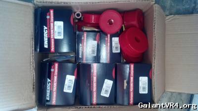

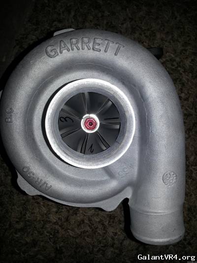

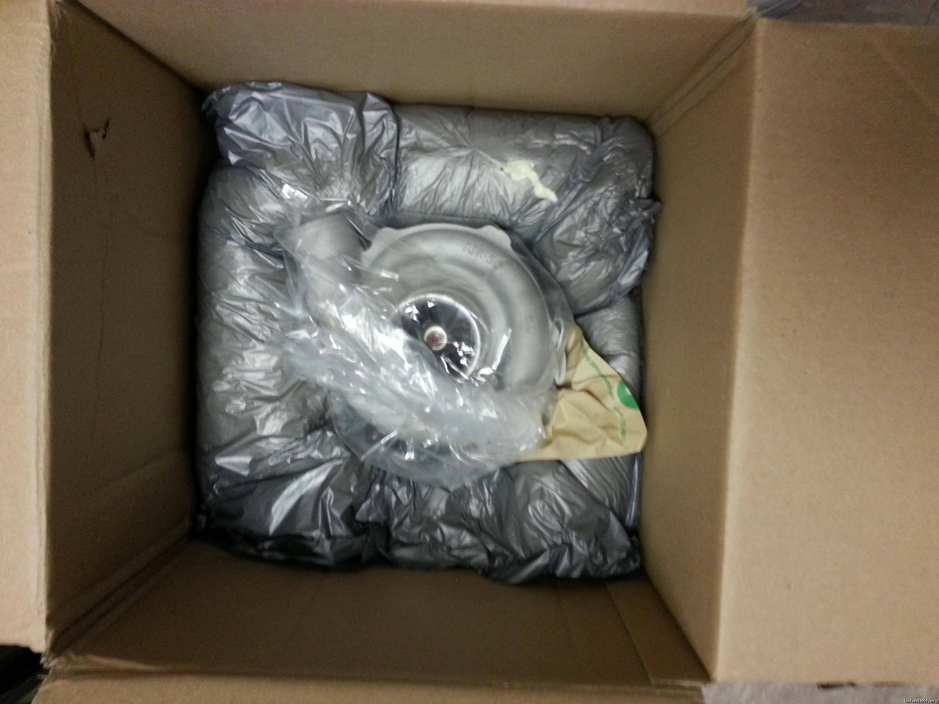

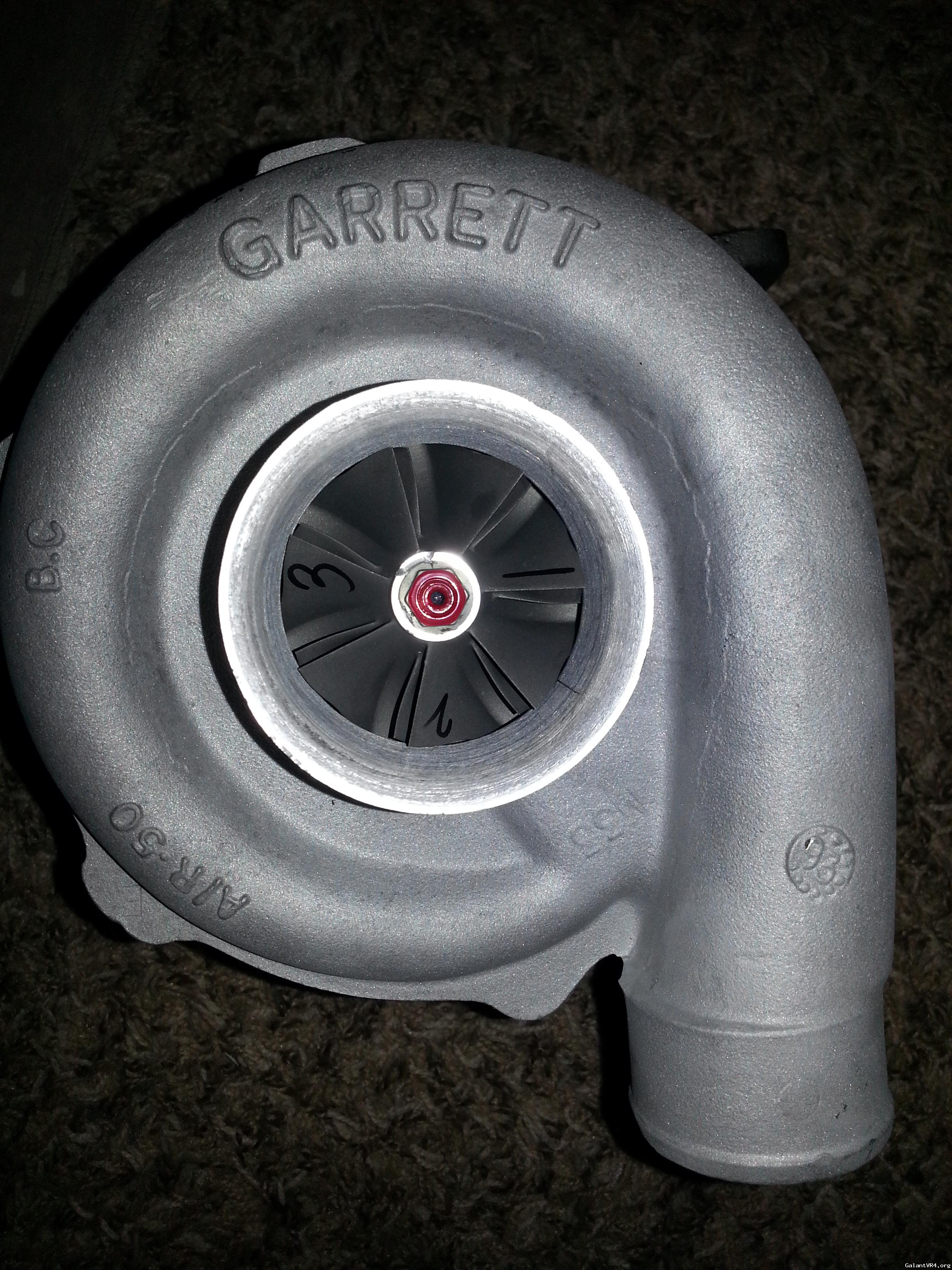

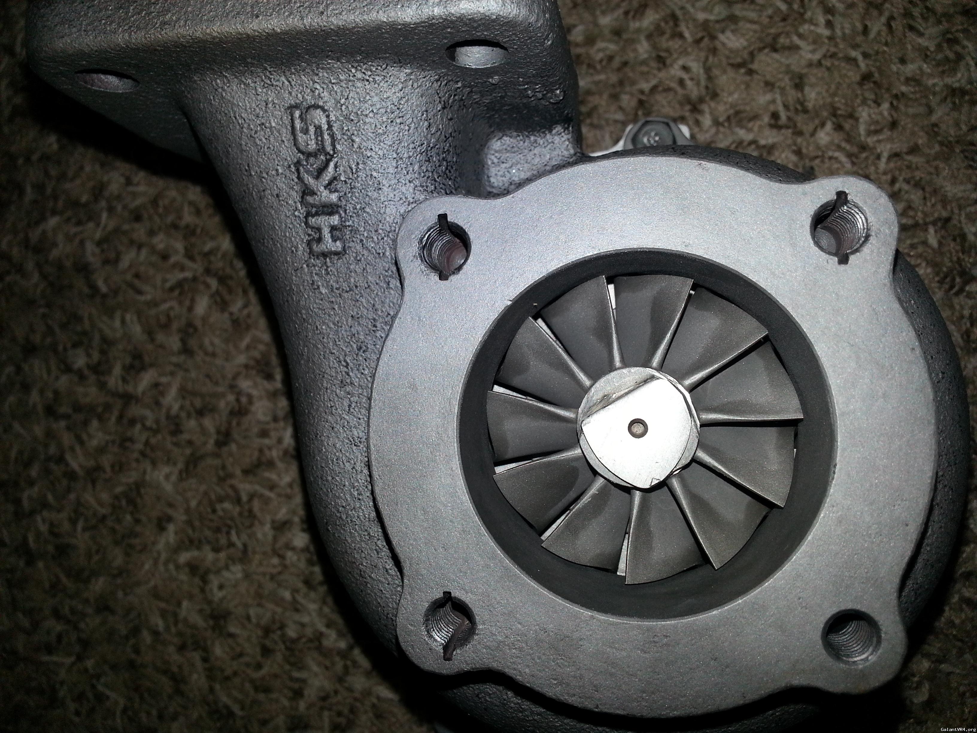

Well today was better than Christmas. I got this
Just rebuilt and upgraded by FP. It now has a 60-1 compressor wheel stuffed inside. SHould make things pretty fun /ubbthreads/images/graemlins/devil.gif

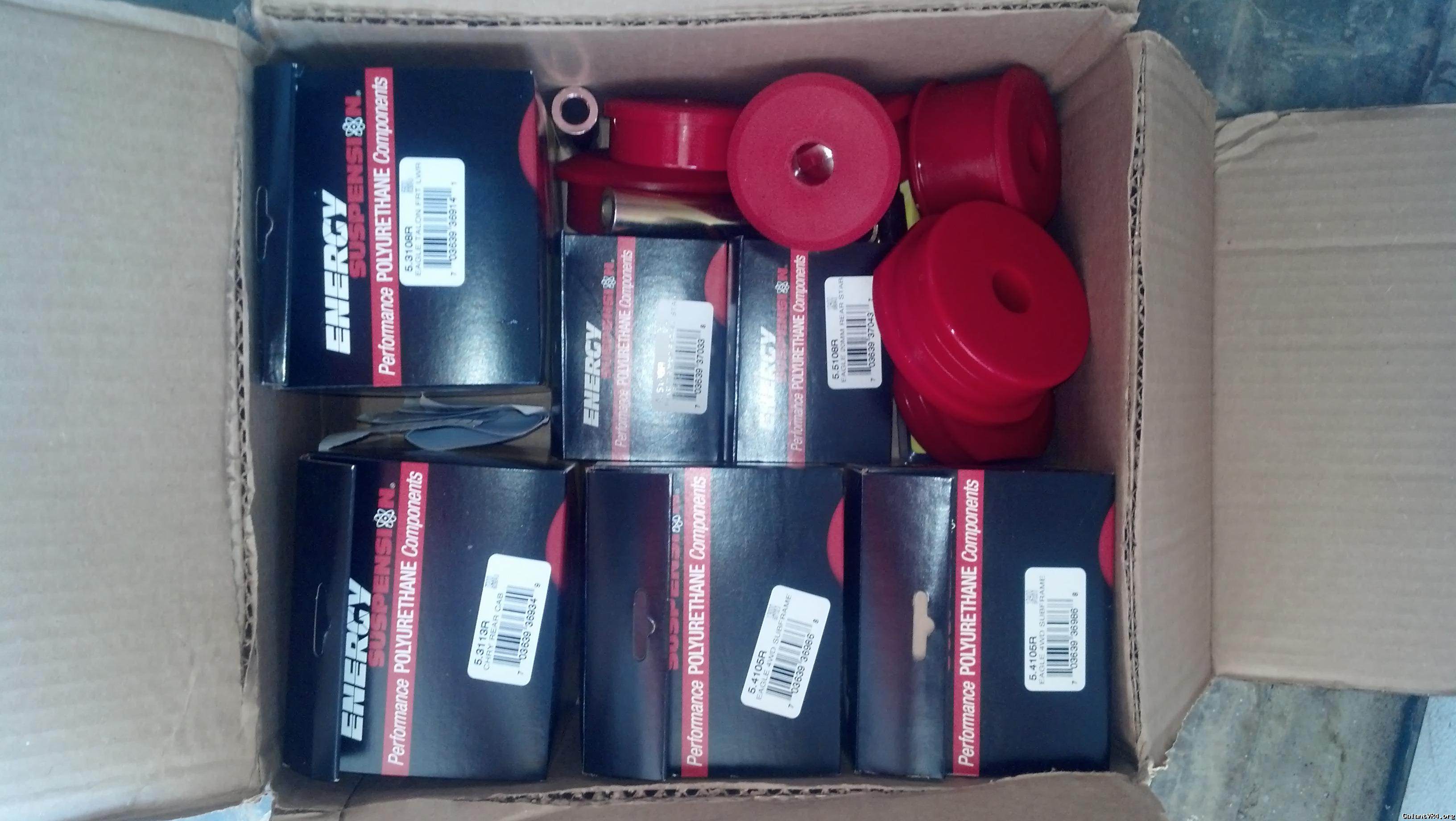

Im so far beyond stoked right now. Eris is coming together slowly but surely. So far the parts I have gathered are
9.5:1 pistons on shot peened rods
ACL tri metal bearings
3g lifters
crower springs and retainers
1mm oversized valves

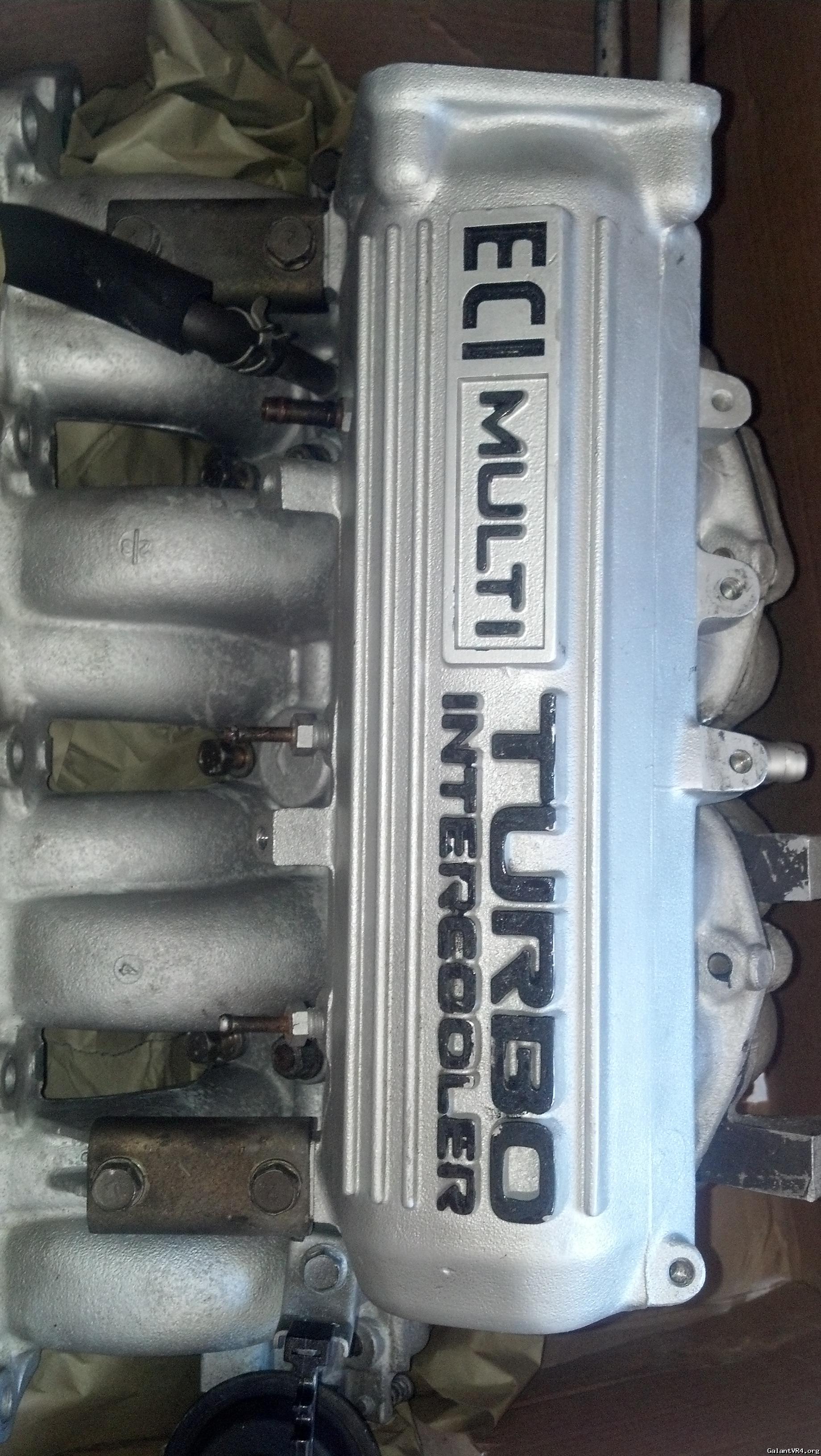

cyclone intake manifold
poly bushings all around
fresh rebuild/upgrade for my HKS turbo
uncut crank
10%taller 5th(but it looks like it ate rocks. Still sorting it out with the seller)
Im sure there are a few more things I have forgotten, but soon I will be shipping stuff to Phil. This weekend I will be attempting to finish up the engine bay so I can start focusing on other parts of the car. There is a lot of surface rust to clean up and take care of. Its going to slow down for a few weeks while I get money saved up for the final push.
