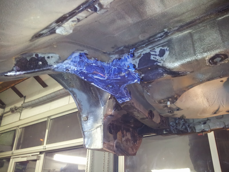

The first 3 weekends were spent for the holes where the side skirts are mounted - they were only held in place by the glue stripe - and the rear left & right holes.
On the left side i just cut away the whole side pocket where the car jack would be - it was so rusty, i just poked through it from all sides when searching for some good sheet to weld on.
Then i dropped the rear axle, fuel tank and all mounting backets and brake/steering lines. All lines underneath the car were rusty and some already started to leak when they were bent just a little bit. So _all_ lines will be replaced by new ones through the passenger compartment.
Then i spend 3 days underneath the rear end, getting rid of all rust. The frame was gone on both sides where the diff support is mounted, so i removed all rust and reinforced this part with 2mm thick steel plates which run from the crossmember over the frame up to the support sheet of the rear strut. As the car will get strut braces front & rear i didn't go all the way up or added other sheets for reinforcement.
every spot of blank metal was passivated, coatd with zinc, filler and silver paint + clear lacquer. (pictures are mainly taken with the passivator freshly applied - its the milky stuff)

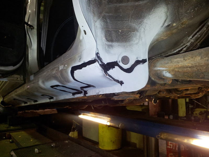

After a "slight hangover" from new yar's eve I continued my work yesterday. Had to eliminate some small spots of rust underneath the trunklid seal yesterday and today i removed everything underneath the middle of the car and stripped the interior.
The underbody didn't looked that bad on the longitudal members:
I had expected worse, especially underneath the exhaust heat shield, but even the outer fold wasn't that crispy as i expected it. On my FWD I could poke through it nearly from front to rear without any good sheet of the floor panel left, but here i have at least a stable structure and also no damage to the longitudal members.

I also started to remove the seam sealing from the floor panels to the side member and as expected it was quite crusty underneath. Didn't take any pictures yet, but tomorrow i will remove all the sealant and take pictures of the whole mess...
I will most likely cut off the rusty inner sheet of the fold underneath the side sill and reinforce it with a 90 metal bracket from front to rear plus welding the side member and floor panels together every ~5cm to add some strength. I already did this mod to a lightweitght Colt CA0 bodyshell I built a few years ago and it adds a lot of torsional stiffness to the car at very low expense...

Anyways, I continued my "rusty business" last weekend. I planned on bolting the rear axle back on to get some weight to the back of the car, but when i accidentially pushed away the rubber base on one side, i tried what happens when removing the rubber base on the other side:
well... perfectly balanced
I left the strap for safety, but it had no tension on it. I could easily bob the car with one hand up and down
As i had enough room now, i cleaned off the rear side sill ends I had scheduled for later
Now came the crispy parts... At the transition to the floor panels 3-4 sheets of metal overlap on some regions. Thats where the rust was really bad so i had to cut out some parts:
preapring the new sheet of metal
And after ~1,5 hours of slowly welding spot by spot and embossing the plate to recreate the beading within the floor panel:
The seam doesn't look that deep on the picture, but its ~1,5cm deep and curved at the edges. Quite tricky when you don't have that much metal left underneath to recreate the structure. I had to lean underneth the car with one arm to support the old sheet while embossing the new sheet from above...
Same procedure awaits on the drivers side :P

Last weekend i put the rear axle under the car and we moved it to another lift. I removed the dashboard + everything underneath and exposed the holes i already saw from the outside:
Then I started to replace the outer side of the drivers side floor panel:
(forgot to take more pictures of this part...)
This Weekend I continued at the drivers side and removed the crossmember to replace the rusty parts underneath:
And again the outer edge where the floor panel joins the sill:
Finished:
At the front I'm waiting until I know how much I'll have to replace from the RHD frontcut, then I will finish the last ~30cm. At both sides i'll replace the whole outer part of the floor panel so i will have a rust-free connection to the sill.
I also started to remove the rear outer part on the passenger side - here I had to remove a much wider part of the floor panel:
The shape of the floor panel is a bit complicated to recreate. I already made the basic shape with the increment and the fold. I think i'll do the ribbing step by step on afternoons this week...
