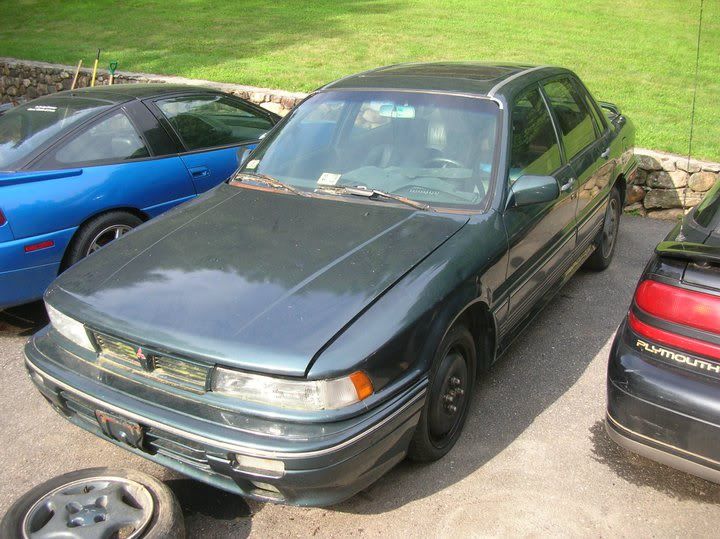

so a few weekends ago, i picked up 73/1000. my first gvr4. supposedly needed a "transmission and an FMIC" and that was the lot of it. also that the car was remarkably clean. while it is a pretty straight body, mostly clean, she has her imperfections. the body has some rust... im not very happy. i drove 5 hours for what was guaranteed to be a clean car. i got a halfway good deal on the whole thing, i suppose if i have to part it out than i could make back what i paid. til then, shes destined to be the spare parts gvr4 beater.
so far i have:
cleaned out the tons of crap that came with
installed good used trans/tcase
installed good used slave, ss clutch line
new 255hp fuel pump
removed 16g for fpgreen setup
new shifter cables (there were none...)
1g shifter
cleaned up/removed all rigged wiring
removed A/C
so when i got the car... the fuel pump housing was out, the tank was full of varnished gasoline, the pump had definetly seen better days, no shifter cables, ABS unit leaks all the brake fluid, no radiator/brackets, so on and so forth. id love to find another belize green or summit white roller and swap it all into it someday down the line... ive got to enjoy this one first. or at least try.
the good news: the key i got was a curtis brand key!
i need to buy the rest of my 5 lug stuff, got a 4 bolt rear and subframe ready just need the front spindles now. need the non-abs kit too. also need to buy a yoke recall kit as mine is so rusted i couldnt slip the transfer case on it... oh well. and the fpgreen with the manifold gate does not like the full size radiator, so half size time it is. a set of injectors, afpr, a gm map, then the VPC i got layin around goes in. got to fab some FMIC piping, and install this evo8 FMIC ive had collecting dust for so many years! so many little bits and pieces. i just want to drive the effin thing! soon enough. thanks for checkin it out.

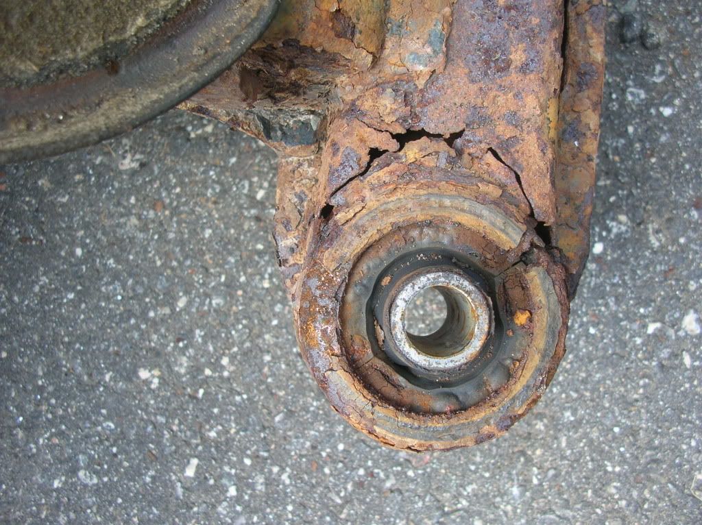

updates: the fate of the car is for it to be a beater. upon closer and further examination, the rust isnt structural... yet. its going to be a budget beater, and it will go pretty good, all things considered.
got the old 4 lug, 4ws subframe out. boy am i glad. one of the ears that holds the subframe bushing was about to crack off because of how rotted the subframe is. the rest of the 4ws lines went too. what a fight that was! they either came off by barely touching them, or like the underhood ones, i had to really fight with them to get them free.
in its place went a very clean 1g TEL subframe with a MINT 4 bolt LSD rear, KYB's on 1g intraxx springs, and a set of 2g 16" GST wheels i got for dumb cheap. its slammed pretty good, i like it. the front struts/springs to match are in, just with the GVR4 strut tops. it looks very nice so far, i havent got the 5 lug spindles in yet (thanks Paul!) to do the swap and put the GST wheels up front but i like how it looks. the setup in the 1g looked almost too raked for my opinion, it still has a slight rake in the galant but it looks great! need to buy one strut to replace a blown one i found when i was swapping the springs around. also got a set of 5 lug drilled/slotted front rotors to top it all off!

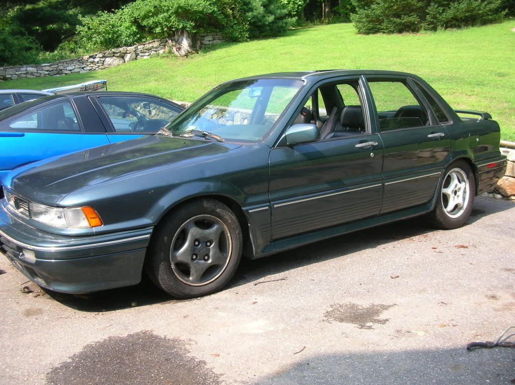

the good, the bad, and the ugly. earlier this month i had made quite a bit of progress. on wednesday, 73/1000 fired up and ran! the engine included in the car is okay.... so far. i ended up using the 1g short route FMIC setup i had laying around, and borrowing a TiAL BOV from the blue car. it came out nicely, the only thing left to do is to cut the bumper up to fit.
you cant see, but i had to make a funky contraption to conjoin the FPgreen and the 2.5" piping. when i do the prothane engine mounts, im going to clock the turbo up to change the angle a little bit. the wastegate dump tube has been cut, i think im going to unbolt it and rotate it to change the pitch of the dump tube. right now it would be blowing on the LICP, and thats not good.
on wed. i got a fresh 4 gallons of gas, and tackled the last neccesities under the hood to start the car. i went to fill the gas tank, low and behold that damned rubber filler neck is leaking. cursed up and down for that mess. it stops dripping, i go to start it. no start. check under the hood, got no fuel pressure. turns out the CAS i had laying around was bad. dug through the basement, found a working one. installed, cranked for a long time, then finally started and was weak to run. i have my girlfriend start it while i look under the hood, fuel pressure is low and as soon as it would stall, it plummets. look under the drivers seat just about, and theres a steady stream of gas coming from the hard feed line. WTF.... i cannot get a break with this thing. so i find fittings, i disconnect the stock line from the sender (yeah it actually came off without breaking!) and i put the metric to AN adapter and a -6 male pushlok fitting. turns out im a few feet short of line to do another tank to filter. so i order some more line.
now today, this lovely saturday that everyone is freaking out about because of this stupid hurricane, i wake up bright and early as its my only oppertunity to register the car. get down there, pay my $92 to the damn state of CT for a damned temporary paper plate and 10 effing days to get emissions done... to come back and pay another $130 plus the $20 for emissions to get a real plate. JNZ says parts will be here wednesday... okay cool. just to get the brakes bled and situated and im good. so i go home after the DMV, and i have the rear on jackstands already. i fill the master, and i start to pump the pedal. resistance! yes! then spongyness... followed by a losing pedal. "maybe its just air" i thought, seeing as the system was bone dry for god knows how long. but no... one of the hard lines to the rear calipers has a hole in it and it will not hold any pressure. so now i need to buy brake line and make them from the prop valve to the rear calipers... wonderful. and judging by all the brake fluid bottles that came in the car, and the residue, im pretty sure the ABS unit is leaking too...
god i love this car. but i hate all this crap ive had to deal with along the way.
current list of stuff ive done to/installed on 73/1000:
- cleaned out interior hardcore, pulled out seats and pulled up carpet
- installed entire new driveline in car, including some hardware (d-shaft to rear diff)
- 4 bolt and DSM subframe, front axles, trans, t-case, driveshaft yoke, solid d-shaft bushings
- good slave cylinder, and 2g SS clutch line added
- new walbro 255 fuel pump & sender hardware
- radio wiring fixed, along with haggard speaker wiring
- random turbo timer wiring/other misc haggard wiring under dash removed/cleaned up
- new front seats
- 1g shifter & boot
- new shifter cables
- VPC/GCC setup installed with GM 3-bar MAP sensor
- FIC 650cc injectors installed
- Aeromotive AFPR kit
- Fuelab -6 filter with -6 pushlok feed & regulator lines
- 1g short route FMIC kit with TiAL BOV
- FPgreen setup, tial 40mm gate, FP 4" intake pipe
- half-size aluminum radiator and slim fan
- rear brakes including right rear caliper & now rear hard brake lines...
- front 5 lug FWD spindles & drilled/slotted rotors
- newer tie rod ends up front (pass side was mushroomed and had no castle nut...)
- eyeball alignment
- newer KYB struts, intraxx 1g AWD springs
- 2g GST wheels painted hideously cream white
- all plastics re-installed
- Alpine radio installed
- engine harness plugs fixed
- removed stripped in wideband sensor, retapped o2 bung
- removed all A/C, 4WS, emissions components
- smaller battery for use with FP 4" intake
- removed broken e-brake cables
heres some pics for you guys to enjoy. im hoping to be driving this thing in the next few weeks. thanks for looking!
