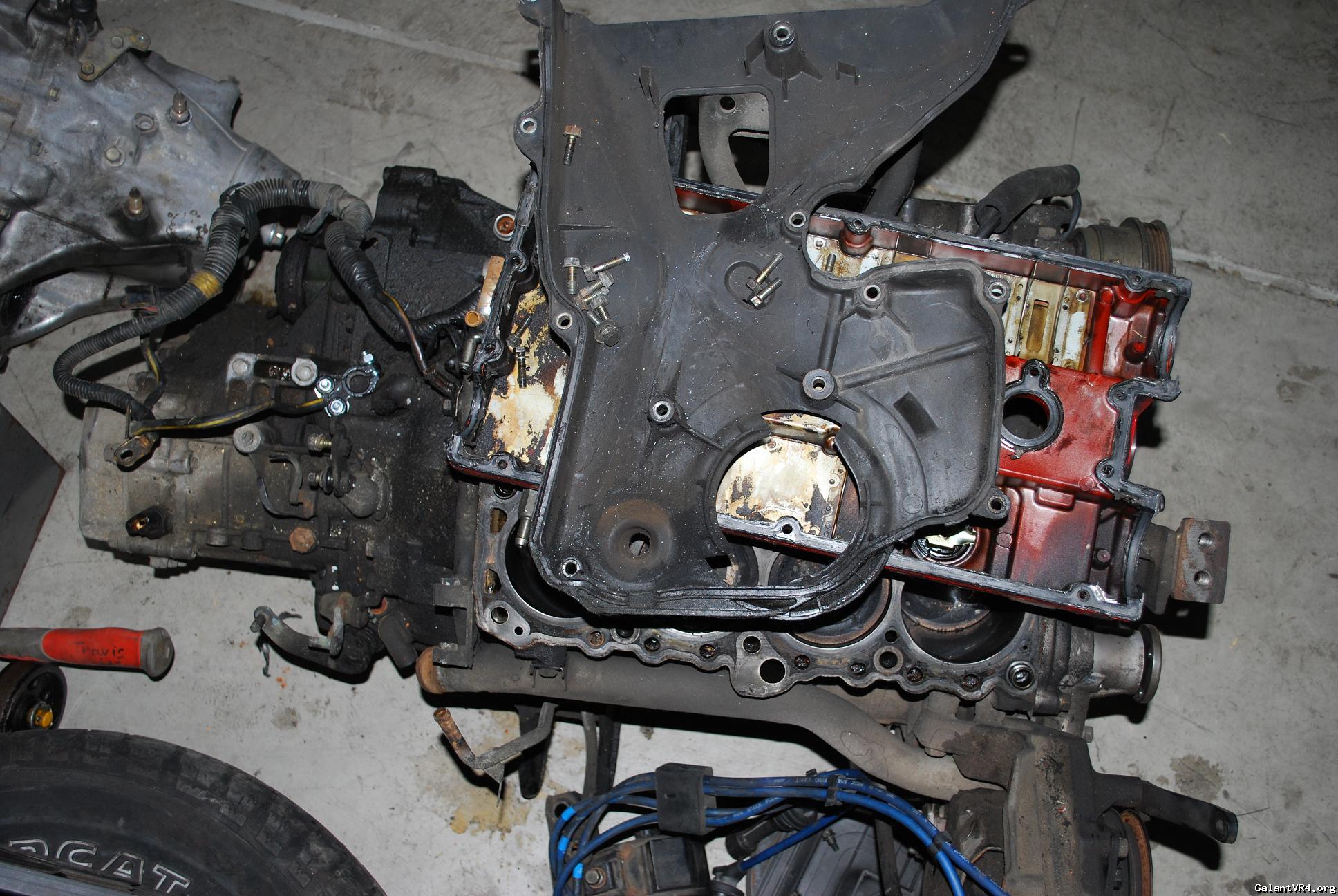

Here is what the engine that I just pulled out looks like after a little bit of cleaning last night. (trust me it is ten times better than it was). this could take awhile...

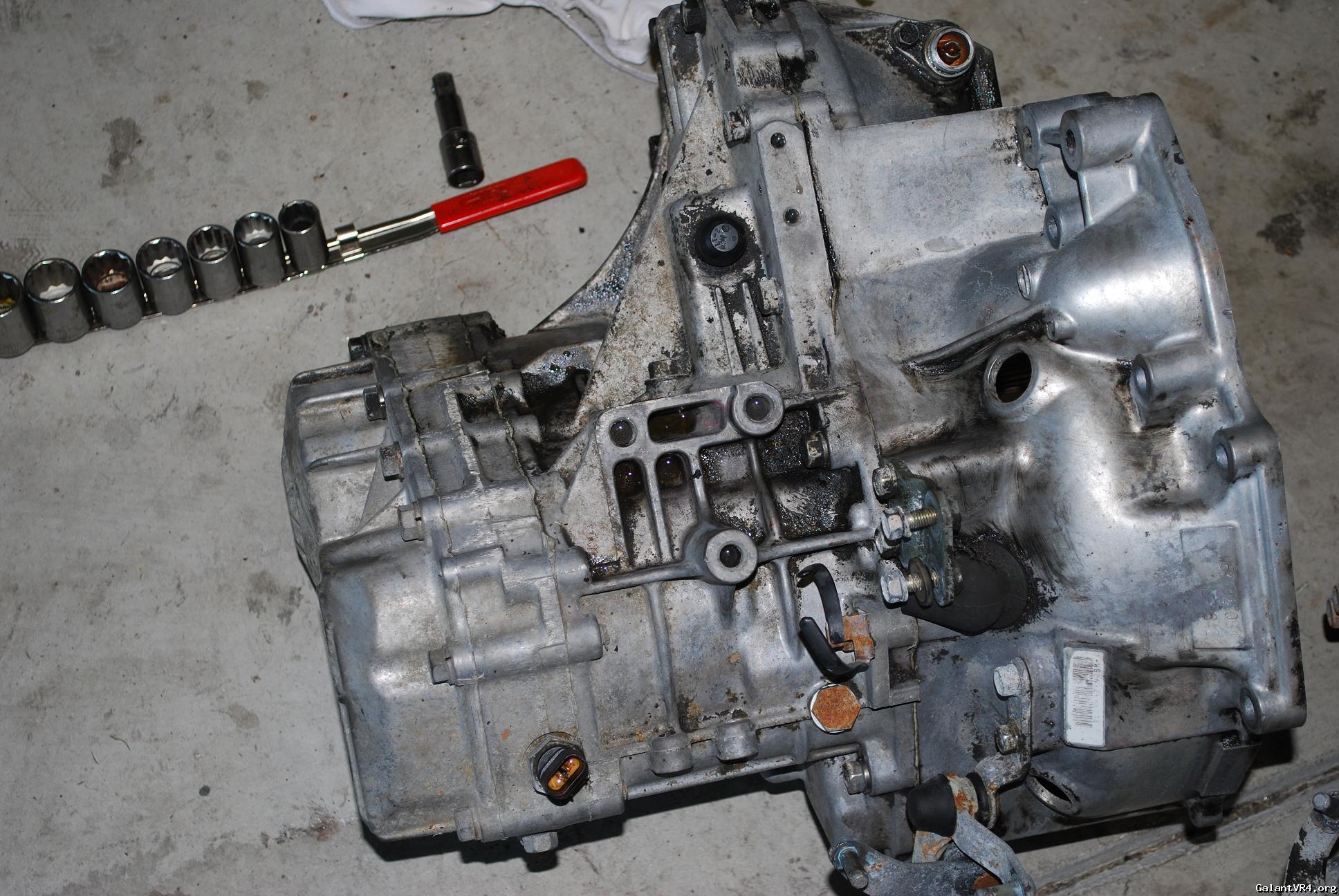

And this is the tranny i have to use from the old motor. CAn you say gunk?

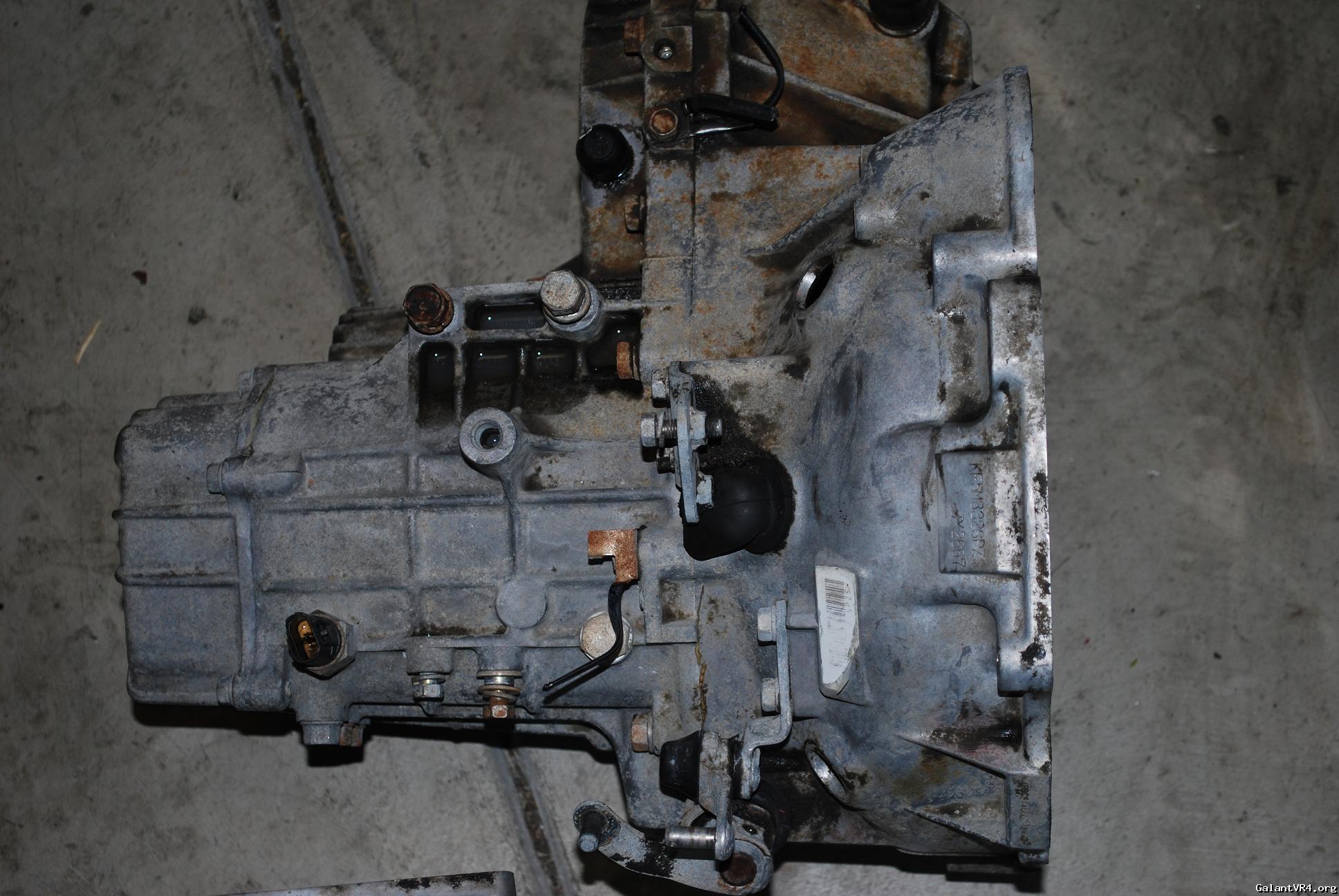

Well I put a dent on both tranny's...Loaded both of them up on the trailer went to the car wash used the pressure washer, Engine brite, oven cleaner, and a scrub brush. Note to self dont stand right next to greasy object when spraying high pressure water at it..it gets all over you

Make sure you flush both of those really well with fresh gear oil before running them. Water can seep its way in through places like the top vent and it doesn't take much to make it shift like shit.
