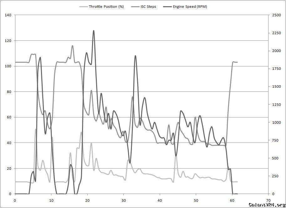

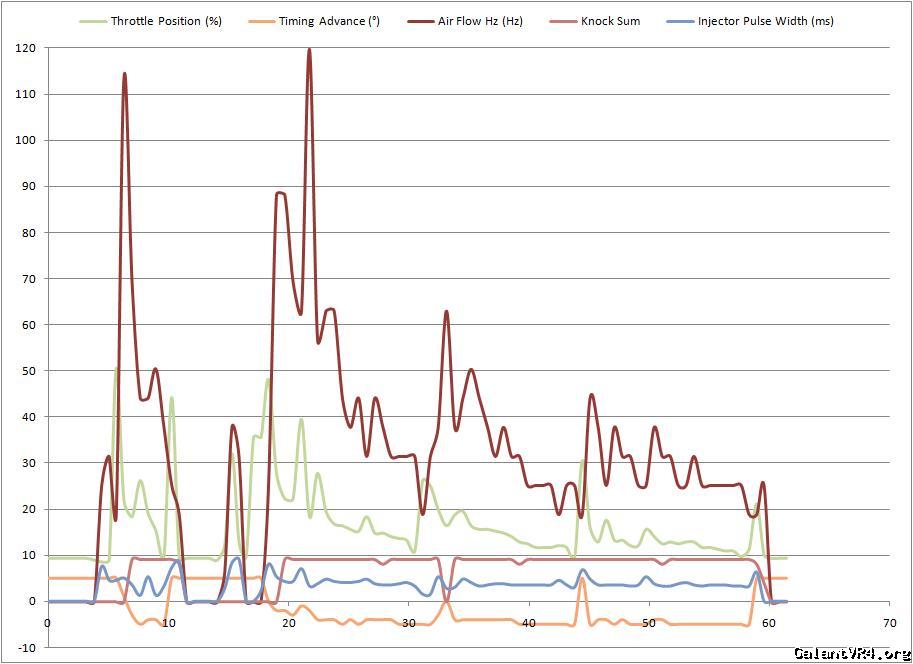

I finally got around to converting my logs.
Here's one where I had to keep the throttle over 10% just to keep the car running:
The Low Fuel Trim is not graphed, but it was at 140%. Mid and High were at 100%.
Also note that my MAF Hz is only being logged at 1/2 the actual value, so 100Hz chart value is actually 200Hz.
So what can you make of this log?

Well, I got off the phone with John (Toybreaker), he suggested a few things. He felt the symptoms described (pulling timing by grounding the timing lead to get idle) are classic-case mechanical timing misalignment. I'm going to go ahead and double check my timing marks tomorrow, but with the Jay racing timing tools I don't see how I could have screwed that one up. When assembling the engine I double checked all that stuff, spun the crank around a few times, checked again. Maybe my Fidanza gears aren't marked correctly, I'll verify by comparing them with a stock cam-sprocket.
Something else that didn't seem to make sense to him is that my ECU log is showing coolant temperature at 241 degrees. Which I guess isn't possible I bought a 180 degree T-stat and new coolant temperature switch (signal feed for the gauge since I broke the tab off). Maybe I should trade in for a 192 degree T-stat and get a new coolant temperature sensor as well (ecu signal feed), then double check that I have the correct wires going to the correct sensors.

posted 09/24/09 06:31 PM     Remind Me!  Send Private Message    Edit Post
I decreased dead time to about 216uS trying it out in 24uS increments from 330 down... the sweet spot seemed to be around 240-264. It helped a bit, but the car will still only idle when I lock the timing by grounding the timing lead. I drove it to the gas station and back. I thought I was going to die because I'd lose power brakes and power steering each time it stalled, and of course I hit every light between here and the gas station. Anyway, I've given up on trying to get it running for the Factory MOD event and will use my leave to go visit friends instead. I'll try to get another log in to view my low level fuel trim (should tell me if I need more or less deadtime), probably order some new injectors, find a new MAF, get a new Keydiver chip.
Time to garage this baby. Looks mean in black and white though.
