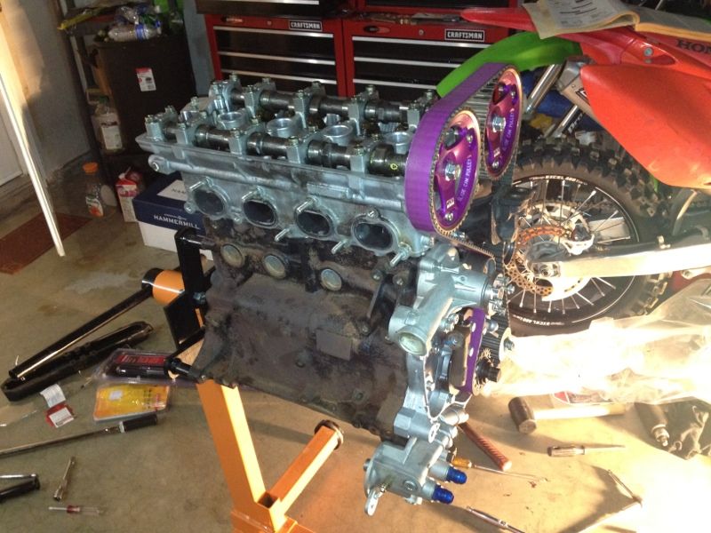

Galant VR-4 org Post #: 1110046 posted 02/22/13 12:08 AM     Remind Me!  Send Private Message   Edit Post
Update!
Wrapped up for the night.

Looks great James! I have the same Harbor Freight engine stand. Some of the stuff they have is actually worth buying.
Just a few things I figured I'd mention I learned over time, and during my last few builds. Most are common sense things that I just forgot trying to rush or whatever. Some of which I could have taken care of while the motor was on the stand, and ended up having to fix after the motor was in the car (making it a pain).
-Make sure the bolts on your adjustable cam gears are tight. Seems pretty obvious, but this was the reason I misdiagnosed and pulled my second motor.
-Make sure you put a little sealer on the balance shaft check bolt, and make sure it is tight, or it will leak oil.
-When you mate the trans and motor, don't forget the spacer/dust plate. It can be installed with the motor and trans is in the car, but it's a real bastard. Ask me how I know... click
-Before your first start up, remove all the spark plugs and unplug all your injectors. Crank the motor and peek inside the oil fill hole in the valve cover. When you see oil getting to the head, on the rockers, cams, etc, the motor is primed.
-After you get the motor in, use the fuel pump activation terminal on the bulkhead to activate the pump. Activate the pump and check for leaks before trying to start the car (so it don't go boom). You can also make an initial fuel pressure adjustment at that time (if you have an AFPR), while the car isn't running. You will have to do it again at idle, but this way it is pretty close already, and not way out of whack during your first start up.
The build is looking great though, and I hope it turns out great for you man. How much of the engine assembly did you end up doing yourself?

Quoting JamesFoster:
Update!
No timing covers?
Looks good though man, i like! Which rods did you wind up going with?
What are those BMX frames in the background, BTW?? Lol

Yeah I agree about Harbor Freight, definitely only buy things with no moving parts from there.
Thanks for the advice, I actually thought of the cam gear bolts when I was putting those back on, definitely something you don't want to forget. Thanks for the other tips as well.
I had the machine shop assemble the shortblock, and I did everything else.
Quoting 5OF2K:
No timing covers?
-Jake
Whoops, thanks for pointing out the timing covers, I went back and put those on after I saw that.
I ended up reusing the Pauter rods out of the last engine.
The BMX frames are just stuff I've accumulated over the years, there's a technique race frame, one of my signature KHE Triple Threat frames from a few years ago, and some other stuff.

Well, I painted the block, got it all together, and put it in the car, just need to put the tranny on now and put everything back together.

Good deal man! I wish I had room to keep all of my old frames and such. I just got rid of my old Mosh 2.0 race frame and my '00 Mirra Pro frame/fork/bars/etc. almost considered classics at this point lol!
Glad to see this thing coming back together, it's by far one of my favorite GVR4s out there. It's just got that "all business" attitude, yknow?

Yes! Awesome to see this car coming back together!

Looks good..shoot a vid when u start it !!!!! U gonna smog that?
