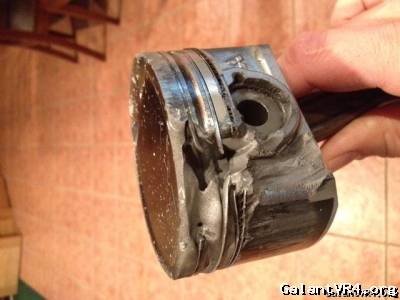

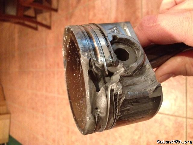

Oh, and by the way, Tim blew up the engine in October. So, we are really starting off the season without a motor. It is going to be THAT kind of adventure.

Looks like Tim has a new pendant to wear on the 2012 trek
Holy crap what happened. That's some serious heat to melt that much metal. OK lets see the other 3 Maybe a lean condition and could be something in the wiring harness and maybe number one injector isn't firing correctly. I would want to know the cause before I risked even starting the new engine.
Oh one more thing is this on E85 or normal 93 pump juice?

Quoting curtis:
The other 3 are damage free and it was on 93 octane.
Sadly the car needed to be retuned, and I openly admit I do not know enough to comfortably make the changes any more. I am alright leveraging one table against another, but as soon as the dual mivec entered the equation, my brain lost the concept of what effects what.
I do have to get the video from Sean. He was on the track at the same time and Tim went past him around turn 10. You could tell the car was running lean and something was off.

How did the head look?
nrvous
(One Member)
01/30/12 04:29 AM
Re: Piston Melting in the 4B11
The head visually looks fine. I couldn't tell if anything went through the valve seat, but I did not disassemble the valves.
