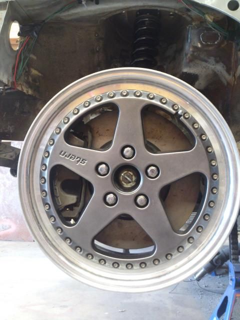

Nice wheel choice. What are they?

Kind of look like my Work Equips, but the angle of the lip where they are bolted together looks deferent.

Looks good, I think that sidewall is too tall though. Will probably rub.

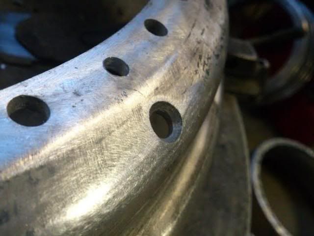

They're old Stern wheels. They came on early Saleen Mustangs. The lips are redrilled HRE pieces. RUB? Yeah, I'll keep an eye out

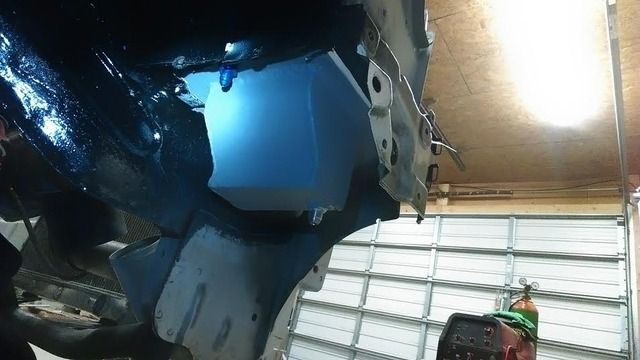

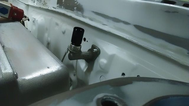

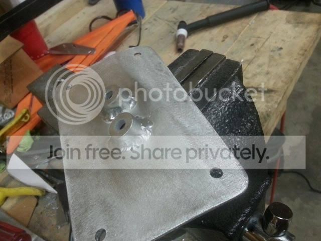

Some neat stuff going on here, keep posting whatever snippets of this. Brake fluid reservoir in the cowl?
BpuVR4
(Rolled by Accord while sauced)
03/07/14 06:35 PM
Re: Quite possibly a build thread..

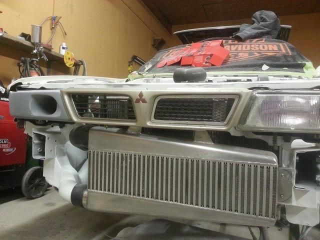

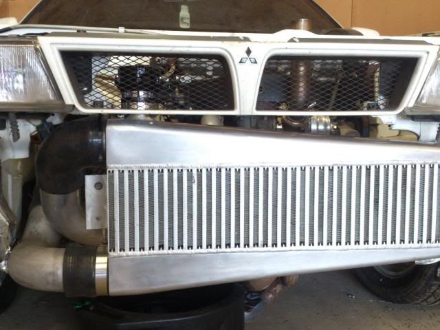

what kind of intercooler would that be? whole thing looks amazing!
15psi88
(Member)
03/07/14 07:03 PM

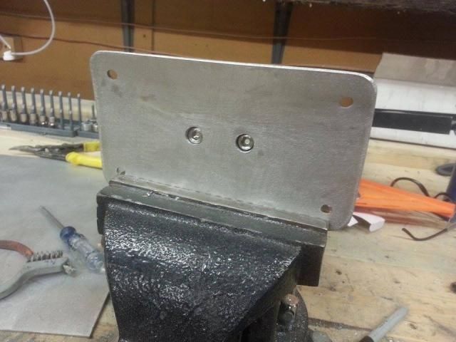

The brake fluid reservoir is actually built into the bottom of the steel plate, and it mounts strictly by the stainless hardware seen around the perimeter. The top plate still needs the flush mount cap welded in, but it will be painless to fill it. Been fighting with myself to powder coat the fabricated pieces wrinkle black, or paint them white when I do the bay. Whatever I do, I'll wish I did the opposite.

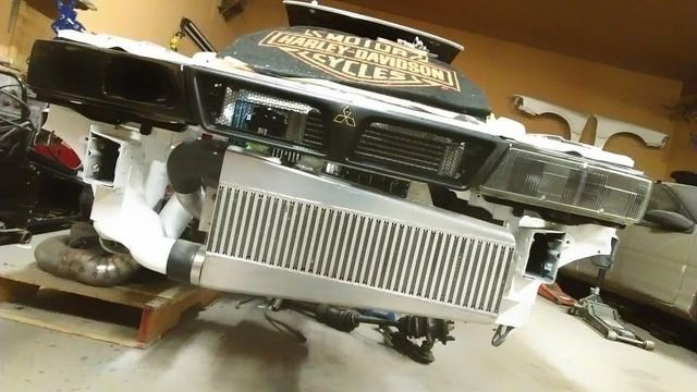

The intercooler is a Treadstone piece. Can be found here
I'm hoping to have the radiator mounted and have the left side of the intercooler finally bolted to something.

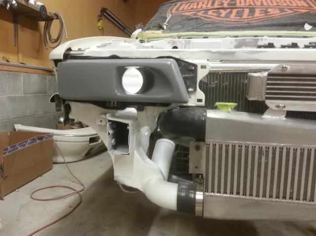

15psi88
(Member)
03/17/14 08:33 AM

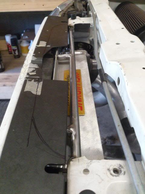

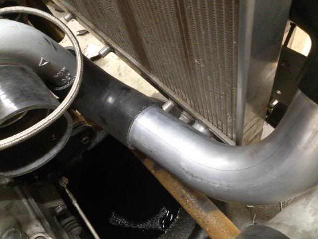

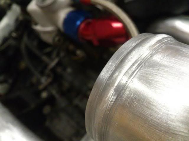

As always, two steps forward 4 steps back.
Getting things sorted to mount the radiator.

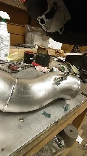

Turns out I can't fit a -20 fitting between the hot pipe and the front cross member. Never was a big fan of running a silicone coupler off the turbo, but at the time it suited my needs. Something I knew was going to need updated in the future...Well the future is, now. I've now got a 2.5" cast elbow to weld on the compressor housing and will be using 2.5" tubing rather than 3".
I think with the tighter radius of the weld on elbow, and using a smaller diameter tubing I can sneak the big ass fitting past. Time will tell. Ran out of argon welding up my wheels over the weekend so progress stopped.

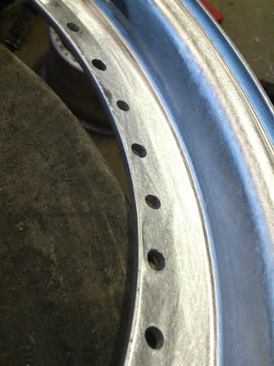

The wheels used to have a stainless 90* valve stem that came out through the face of the wheel. My OCD radar did not approve. So, now I have completely hidden valve stems. When I finally assemble the wheels I will orient a spoke to cover the valve stem.
In other news, I ordered a powdercoat setup, 50lbs of soda media for the blasting cabinet, and a bead roller. Hopefully I can keep some decent momentum and have this pig ready for the shootout.

Right on. What are the specs of the Sterns? (size and offset)
15psi88
(Member)
03/18/14 08:26 AM
17x7.5 +32
Turbo99
(Junior Member)
03/18/14 08:55 AM
Did you build them to those specs?
I looked for Sterns or reverse mount sterns for a while and could never find a square set. They were always staggered.
15psi88
(Member)
03/18/14 05:38 PM
Yeah, I bought them staggered. Built them to spec. Honestly, the most frustrating task I've taken on this whole project. Safe to say, I'll be buried with them.

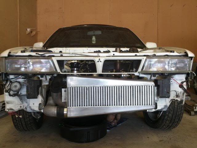

05/15/14 12:39 PM

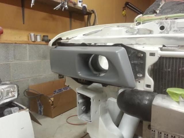

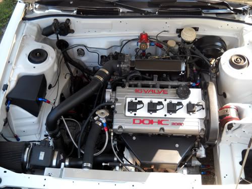

Looking great so far is that a 3in down pipe? ohh yea and what's up that spaghetti farm inside your car what's happening there
mitsuturbo
(Banthony )
05/15/14 01:40 PM
Quoting 15psi88:
I bought my FP turbine housing used from a guy who blew up his 3065 and i was wondering why it was "green". I assumed the previous owner had it coated or something. However, it looks like yours is the same color. Is this some coating they were doing back in the day or what?
15psi88
(Member)
05/15/14 03:13 PM

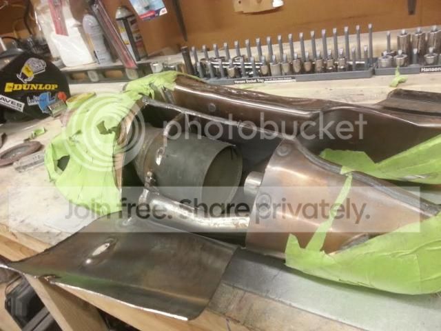

The exact routing of the factory chassis wiring harness escapes me now but, the reason for the spaghetti farm is that the harness used to run out the drivers side a pillar, across the front under the radiator, and over to the original fuse block mounted on the shock tower. I moved the fuse box behind the glove box. "Phase 1" so to speak, I lengthened the harness and ran it inside the passenger side a pillar. Ultimately the wiring harness did a large loop the whole way around the engine bay and back into the passenger compartment.
I removed the dash to remove the HVAC equipment and decided I would shorten the harness.
At this point, two separate harnesses run inside each fender well to (L/R) headlights/cooling fans etc. MUCH cleaner, much more simple.
The PO of the turbo I know had the compressor cover powder coated, but no mention was ever made of ceramic coating of the hot parts. I would guess that it was factory FP applied.
I will be ceramic coating all my hot parts in black anyway, which is why I never thought much about it.
The downpipe is 3.5" btw.

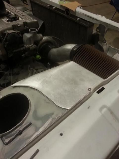

So many one-off mods and parts on this build. Great work. Are you going to stick with that GM MAF setup?
15psi88
(Member)
05/18/14 08:01 PM
I don't plan on staying with the GM MAF. For now though, I just want to get it together and get the bugs sorted out.

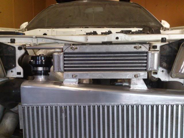

(A hole)
05/20/14 07:02 PM

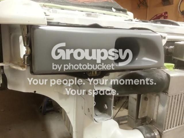

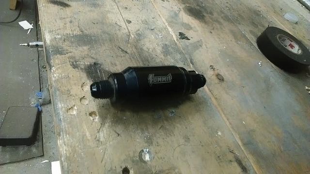

What's that for? Oil cooler?
15psi88
(Member)
05/21/14 08:26 PM
It's for fuel.

15psi88
(Member)
05/22/14 02:45 PM
I assumed by asking the obvious you were hatching a plan to negate my usage or need for an oil cooler so I made something up to foil your plan.
(A hole)
05/23/14 11:49 AM
I'm not sure how "obvious" it is, seeing as it's located in the grille. As far as plans go, you got me all wrong, brah. If I were trolling you, you'd know it. I suppose my question should have been: Why are you mounting an oil cooler in the grille area? The front bumper area would have made it too easy for you, or what?

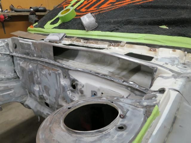

I like what you did with the fab work on the ABS area.
15psi88
(Member)
06/30/14 10:19 AM

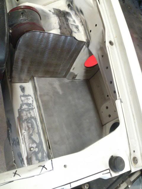

Thanks. I'm hoping the hidden motor mount hardware doesn't come back to haunt me.
I know it looks rough with half the paint missing at the moment. Since I stitch welded all the seams I plan to dress the welds smooth and re-seam seal over it to blend it like factory.
All the unused holes have been welded/are being welded. Including the hole where the factory engine harness entered the bay.
The upper radiator support was miss-shaped and always set my ocd radar off. I'm working on making it nice and uniform now that it doesn't need to house the hood latch support/prop rod etc.
I can't wait to get it under primer and get a better look at how smooth it's really going to look.

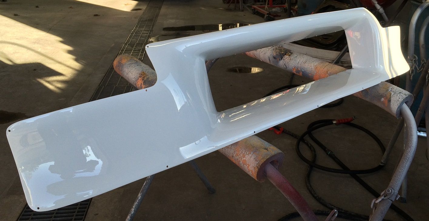

(A hole)
07/16/14 05:37 PM
This is about to be the most custom build in GVR4 history. I can't believe you permanently integrated that intercooler pipe into the frame rail

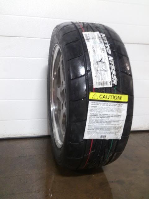

Loving the thread man. Are those tire Nt555 245 50 16??
15psi88
(Member)
07/25/14 02:04 PM
Thanks.
They are 555R's 245/45/17

Progress has been kind of slow recently.
I found a picture while browsing the other day that I must have studied for 10 minutes. Even though there are things I am unhappy with currently, I am still okay with how she looks compared to stock. Some things I don't even remember doing.
Also put something in motion I've been thinking about for a long time. Not certain on the results yet, might end up making a few renditions.
I ordered a 4" 90* coupler to connect the intake to the existing intake tube as well. This wont be just an air inlet
transparentdsm
(I have to say something dumb Member)
10/17/14 10:09 AM
is that lower intercooler piping actually part of the rad support? i really really like that.
15psi88
(Member)
10/17/14 01:08 PM
Yep, It's permanent.. err, sorta. I guess I'll always have a cutoff tool and a welder.

Trying something on the grille. Kinda diggin' it.
ApexHunter
(Extreme Indoor Cyclist)
10/28/14 11:39 PM
Aesthetically it looks bitchin, however i'm wary of airflow blockage, albeit pretty minimal. I assume that you'll be doing something to help direct air to and through your various heat exchangers.
You sir, are a fiend. It's awesome. Please continue.

10/30/14 01:50 PM
I have to say though, I am a bit disappointed to see the BC's on there. I had em and they are not bad. I don't even know what you are going to do with the car, maybe they will be "sufficient". Just not on par with the rest of the build.
Spyke169
(Member +)
10/30/14 07:52 PM
I have to agree with Apexhunter, the grill looks good, but airflow... I would continue with the theme you have for the headlight and add some ducting from the grill to that cooler.

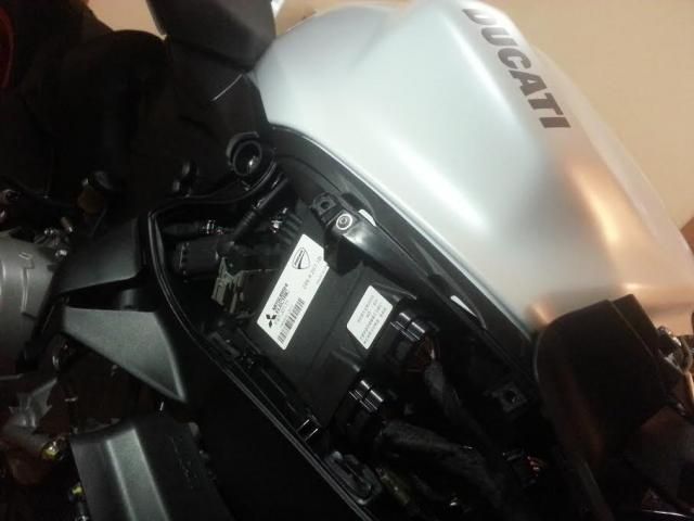

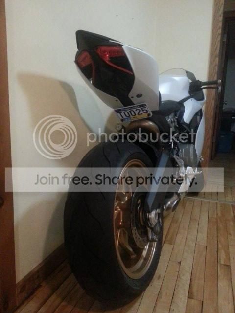

All the usual first mods.. Cut open the mufflers and eliminated the cats, painted the wheels.. etc.
Relevant:
But, I did do a thing on the car.
tektic
(Senior Member)
01/26/15 09:12 AM
I like that cover a lot. I want to make a double oil catch can in my car over there and wanted it to look similar. Nice work.
15psi88
(Member)
01/26/15 09:18 AM
Thanks man. It's still a work in progress. It's going to be a divided catch can/coolant overflow.
ApexHunter
01/26/15 09:21 AM
That Panigale looks real nice. Probably sounds pretty good now too.

I'm a service writer at an independent auto repair shop. Amateur fabricator, at best on the weekends. I don't know about needing an apprentice but if you wanna bring a case of beer we can make all the shit you want.
15psi88
(Member)
01/26/16 10:09 PM
So I realize these couple pics are shit, but I wanted to update this thread.
I've started working on the car again. Knocking out all the small details to make all this stuff work that I have been dreading.
I took a pretty good hiatus when I got the Ducati because I really didn't care about anything else but that bike for the past year.
I got a new daily that I had been playing with recently, so that didn't help with the focus either. I took a position managing a body shop at a Chevrolet dealer here in town. Things have been hectic, but I'm really excited about the Galant again. So much so, I've literally been losing sleep.
The radiator never fit right under the re shaped upper tie bar. It looked okay in the pictures, but certainly not done. That's sorted now so I was able to work on the oil cooler fittings that are WAY tight to the face of the radiator. I ended up ordering 18mm turbo coolant banjo fittings, with adapters to 6an. I was forced to weld the original bungs up and tapping the oil cooler to suit. I've got the 93 grille trimmed out, primed, and new hexagonal mesh fitted. btw- Anyone know where to get a new badge for the 93 grille? I dicked it up letting the little diamonds dry above the wood stove after painting them black. It was hotter than I anticipated ha ha
Anyway, I got a bunch of SHIT done that was a pain in the ass, but doesn't really photograph well.
I ordered a billet valve cover, so I figured it was time to knock out the catch can. A few in progress pictures here. The top side is tacked into place now. I want to wait to get the valve cover before I finalize hose lengths and really tidy it up. I know it looks busy, but it's a necessary evil. I have two 8an hoses off the intake tube for vacuum.
The two 10an hoses off the valve cover gets stepped down to 8an as well. Finally, I have a 6an hose running to the balance shaft port on the back of the block. Which I think is pictured above somewhere. 6an is smaller than I want, but I don't want to drill the block out with out taking off the current oil pan. I fully expect the oil pan to come off by itself in a glorious display of catastrophic failure, probably due to a shitty tune on my part.
However, that is when I intend to put the 2.3L in which has an enlarged hole.
Oh, you can see the coolant overflow is finished now. The three holes in the front are actual portholes into the can to act as sight glasses.
I think that really concludes most of the major fabrication. So, now I'm able to take it apart yet again. This time for final paint and body work- AND THAT I'm really looking forward to.
The new daily I mentioned. It's just a 1.8, but it is awd.

is that Audi slightly worked?? i think i see an intercooler and is that an Oettinger front bumper i spy...
15psi88
(Member)
01/27/16 06:57 AM
I did a front mount,3" turbo back,pod filter,and a boost gauge. 255's on all 4 corners on 17" a8 Wheels. Just an ebay knockoff bumper.

I wish I posted more updates too! Here's a pic of the oil cooler clearance:

The clutch master cylinder reservoir is something I had been brain storming a while. Tonight I found something to work, by accident.

Because shortening a stock bumper was too easy.. and also because there are more cars with JDM bumpers than originals.

transparentdsm
02/14/16 08:59 AM
un fucking real!! kinda love it. now you need a much much larger intercooler or an intercooler/oil cooler combo to fill in the giant hole. i want a straight on shot.
15psi88
(Member)
02/14/16 10:06 AM
Lots of work to do on this yet. I should have waited to post. I know it will be impossible for some to visualize how it will look when complete.(I'd agree right now it looks horrid) I've got to take almost two inches from the height of it, which will make the opening much smaller. I will be making a "funnel" type insert to fit into the opening that will force air through the intercooler.
Kind of like this:
but with a larger transitional area so it wont look as boxed off. I guess it's the same idea as the headlight inlet really..

02/23/16 08:47 AM
bumper looks rad! is that an exhaust? out of the side skirt.
15psi88
(Member)
02/23/16 10:39 AM
Yeah the exhaust will exit through the rocker. I had some rust there anyway. I figured if I was going to be doing metal work I would make it worth it.
I'm going to level the floor with the transmission tunnel behind the drivers seat to get the clearance I need. You'd better be short if you sit back there.

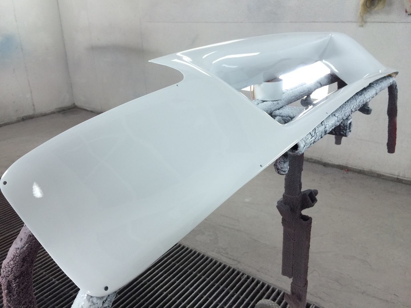

Little slower progress than expected but I haven't stopped.
The insert is body worked and primed. WAY WAY WAY more work than what you'd think to look at it, but it looks MEAN AF.

I brought the bumper for the G with me to work and started on it early this morning. When my co workers came in they couldn't even fathom what I was doing. "Why didn't you just get a new bumper" "that's from a talon?" "You've got your work cut out" They've never seen the car and they think I'm nuts.
I am.
I've decided to start in the front and work to the rear of the car, not progressing until each part is complete. Bouncing around from project to project within the car is overwhelming. Small bites!

Not only did I finally decide on a color, I got to put some down tonight
Every once in a while I've gotta show the guys in the shop I'm not just a paper pusher.

Mmm, crisp white.
I mixed W37, Wicked White, but omitted the gold toner to brighten it up a bit. Obviously I couldn't just have an off the shelf color. haha
Little dry spray near the back there... Shit'll buff out

Ah, at long last, some updates. Looking good! I'm liking that bumper even more now with paint and fitting. Nice bumper supports there.

I started working on the galant again. I'd like to race it at the 2019 Shootout.
I've accepted that it wont be completely painted, and as done as I'd like, but I have to start moving on it.

intake
On another note, has anyone built anything to eliminate the thermostat housing/water neck, without going electric wp? That will be my next project, looking for idears.

How did you get that FRH intake to seal properly? I got the same one and made a gasket using the original as a stencil and it leaks like crazy all around and through the bolts. Any ideas are appreciated. Thanks.
Alot of newer hybrids use electric wp and there may be a model which you might be able to use the thermostat housing from. Just a thought.
Awesome cars btw.

I'm not sure if it's sealed or not to be honest. I can't remember for sure, but I think mine is "updated". I really think that someone had China knockoff the original Forrester, but either way my lower section is cut for an O ring, it does not use a gasket. Maybe that's how they all are?? It's been nearly 10 years since I did any homework.
I don't think a car with an electric water pump would use a thermostat? The pcm would control the pump speed as needed?? I don't have any first hand experience with OEM so I'm jus' thinking out loud.

Moving along on the plumbing, ordering fuel pump today!

Been really looking forward to an update here man...so i'm pretty stoked to see the progress.
Are you still using that charge pipe that you integrated into the frame rail? I always really liked that.

Are you now running a dry sump or am I missing something with that valve cover?
15psi88
(Member)
09/24/18 08:08 AM
I just didn't want an oil cap haha. The vent fittings have a hole in it large enough to put a funnel in anyway.
I'm still using the charge piping setup. Probably will for a long time unless I find the limits of that intercooler.
got some stainless to replace pretty much everything under the hood.
20180921_155529
15psi88
(Member)
09/25/18 09:53 AM
Yup, probably.
20180924_181247
20180924_181304
