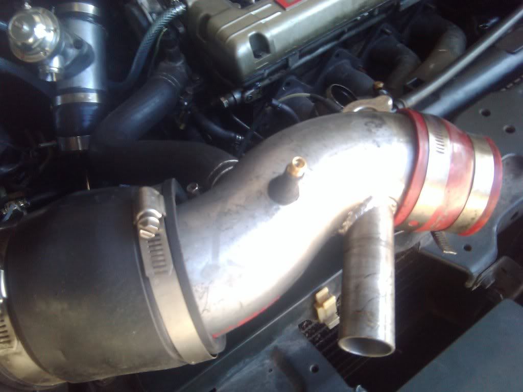

^ Man i hope you arent serious. + this is how the catch can was attached. And sorry man , i didn't mean to hijack your thread. Just putting in my 2c.

Well then sir your hopes are crushed! If you choose to attach a catch can with a valve stem i don't even want to see the rest of your car.
beaner
(Blew1 Guy Today )
01/22/12 08:33 PM
Re: MHI Big 16g
You post a picture of a valve stem on the intake pipe and we are to assume the catch can was connected to it?

Re: MHI Big 16g
Quoting Beaner:
You should know from my post that’s right above your post. And if you boost test your car with a valve stem that’s all on you. I block everything off and use a smoke/air machine like it should be done but to each its own.
Quoting turbowop:
Quoting DDM:
Dude.. nothing was directed to you before my previous post. You just blew a fuse because i disagreed with someone . There is a difference between taking someones side and telling someone to "fack off"
I "blew a fuse" because you're polluting this forum with your misinformation. There is absolutely nothing wrong with feeding the turbo oil from the head. And I'm not taking anybody's side here. I'm just trying to keep anybody else looking for good info on this forum from thinking they need to do something that isn't necessary.
Next time try to put in a reasonable argument so people can see that you are probably correct and im crazy and move on instead of “im doing it wrong? Fack off!” And its not misinformation because all MHI turbos have restrictors on them so the extra pressure wouldn’t hurt but the lack of might be a huge problem especially how 99% of us overboost the turbos as it is.

01/23/12 02:18 AM
Re: MHI Big 16g
Quoting DDM:
The post that had a sentence started with a plus sign? I figured there was an equally useless picture you forgot to attach with it. We're talking about how to feed a 16g and out of nowhere you're talking about valve stems on intake pipes then backtracking on what was connected to it. You bought a modded 20 year old turbo car and found weird shit? No way.
My air machine is a bike pump hooked up to a valve stem. The only smoke machine I own is a ROOR. Both get the job done perfectly.

01/25/12 02:25 AM
Re: MHI Big 16g
Quoting DDM:
Not all boost leaks can be detected with a smoke air machine. What may not leak at 10psi, may leak at 21psi.
One of these..
pressurized to your maximum boost pressure and a spray bottle filled with soapy water is much more effective. Its not a valve stem, but the same concept.
I dealt with a nasty throttle shaft seal leak that was undetectable under 5psi. By 12psi, it was hissing like crazy. On a high performance turbocharged car, a smoke air machine is not sufficient.
