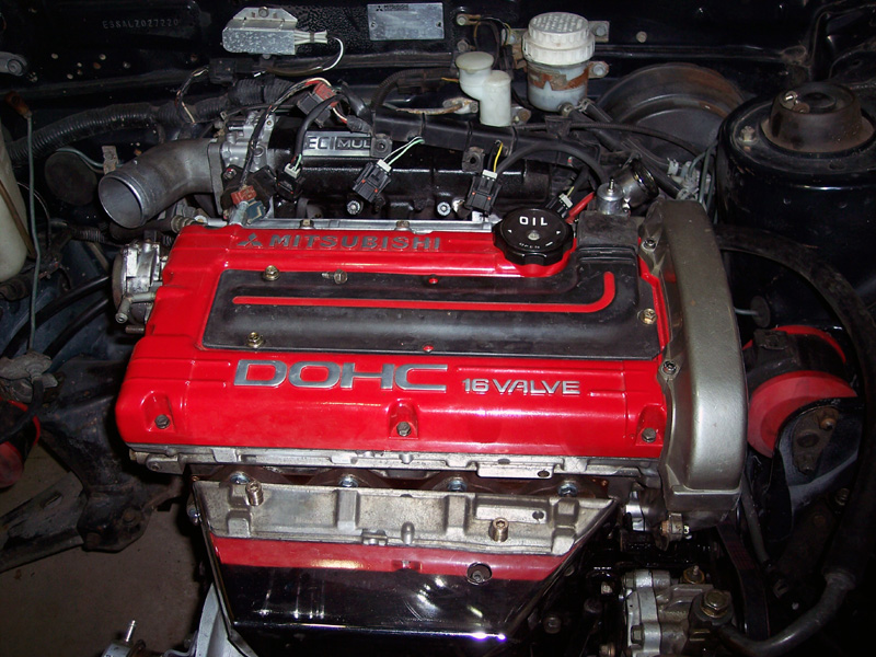

I've got a lot of 2g stuff laying around so tonight i decided to toss the 2g power steering pump etc on the car. I guess just for the sake of looking newer and to be a little different? I'm a ricer, i know.
so far i have, 2g exhaust manifold, o2 housing, 2g trans, 2g slave cylinder, 2g injector clips and now 2g power steering pump. lol.
